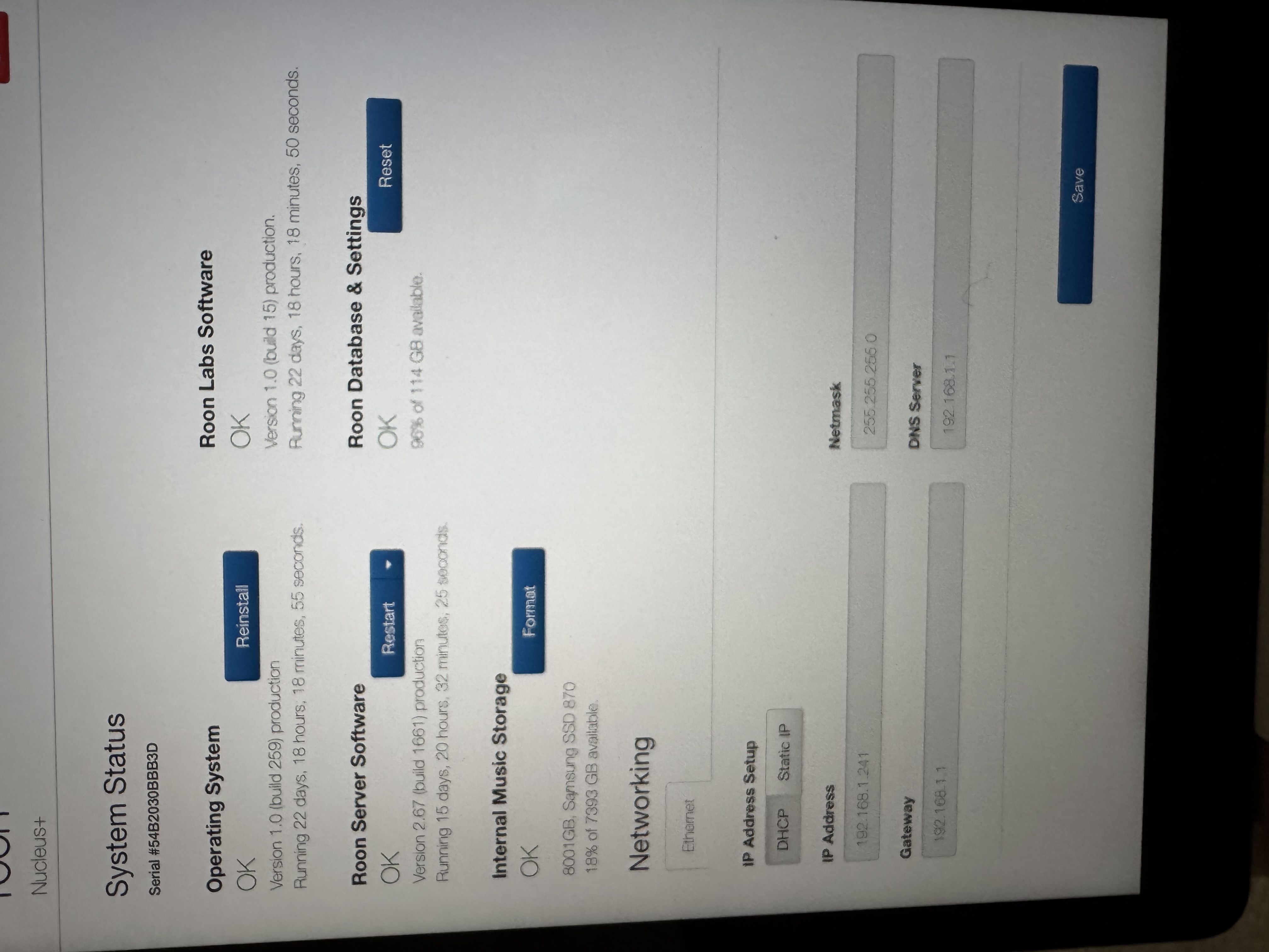

I rebooted my Nucleus plus 2 1/2 hours ago. I Can’t connect with my remotes, yet when I go to the IP address I can see the system status, which is all ok. This happens every time I reboot. Eventually, it returns. It continues to work very slowly, and during playback, whether through Qobuz or my NAS, it skips tracks and stalls in the middle of songs. All very frustrating
ISP 192.168.1.241
Verizon Fios router and extender
Synergistic ethernet switch
Nucleus plus
All hardwired
