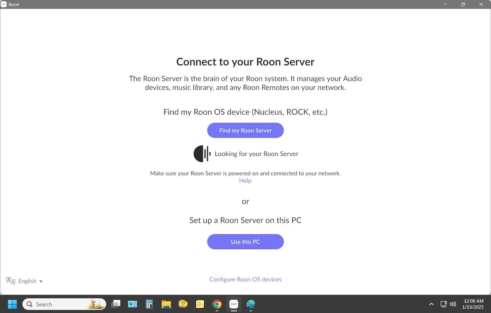

I can no longer connect to my Nucleus Plus. Roon app cannot find my Roon Server. Server is plugged in, turned on and connected to Ethernet. It stopped working overnight. I would greatly appreciate any help.
My network setup has not changed. Nucleus Plus is connected by Ethernet to Cisco Gigabit multiport switch. Router is ROG AXE-16000. Cable Modem is Netgear CM 2050V. ISP is Xfinity, 2 Gb.

Thanks for the reply. Sorry this is late but I was out of town. I tried your suggestion this evening. There is no video output from the HDMI port. The HDM cable connected to my AV processor. When the Nucleus Plus was functional, I would seed the lines of text you referred to. No longer. The power cable, Ethernet connector, and HDMI cable are plugged into the unit. Have tried resetting by disconnecting power cable but no joy. The power switch in back of the unit is on (confirmed by the little white LED light on top).
I tried uninstalling my old Roon PC software. Downloaded current version from website and reinstalled. It does not detect the Nucleus Plus.

Thanks for your reply. I am unable to access the Nucleus Plus via the Roon PC App - not detected by webUI.
