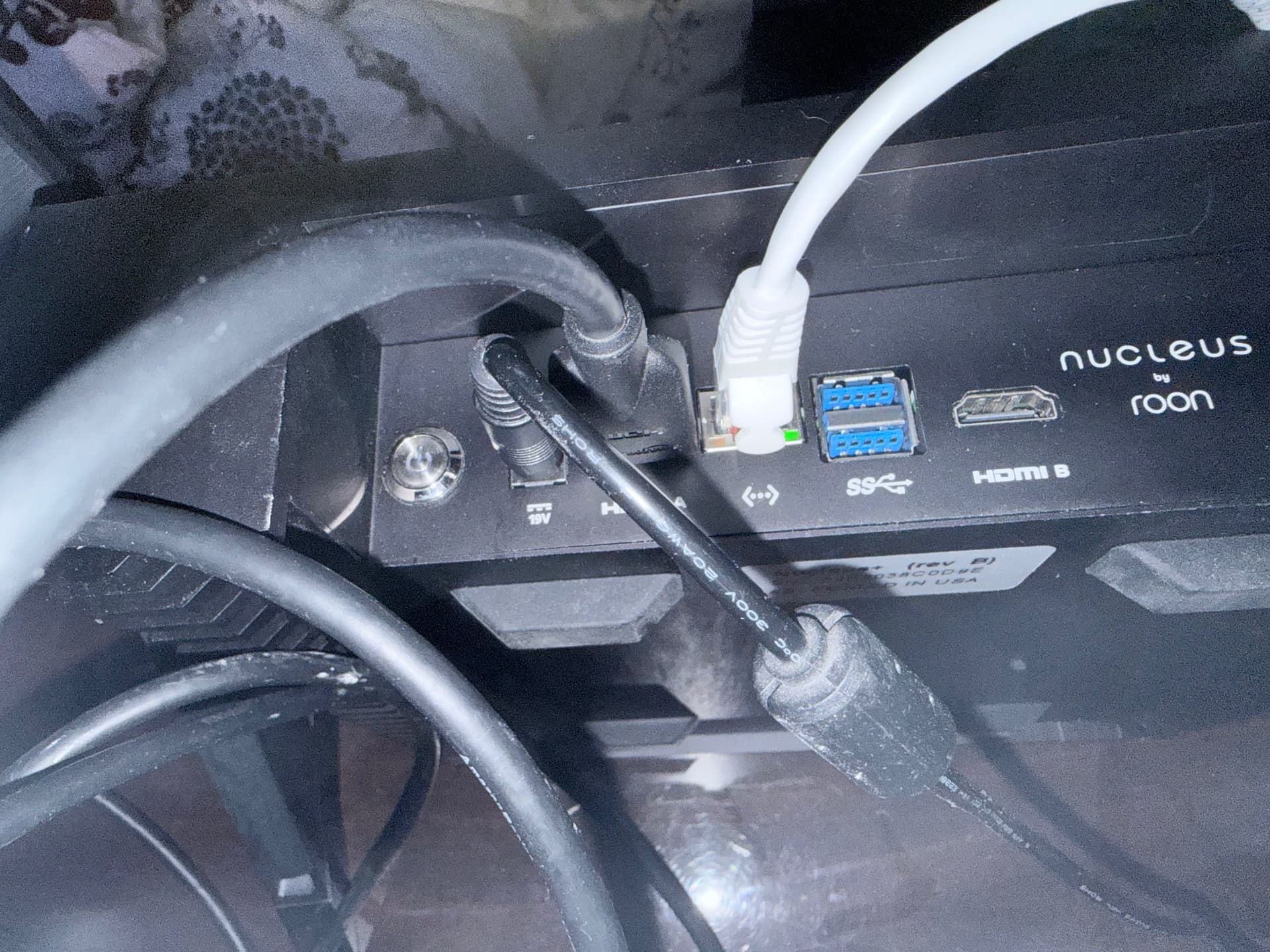

· My nucleus plus is reflected on my network and hooked up through the Ethernet port. The little green light on the right side is on and an amber or yellow light is on too. However, when trying to connect on the iPhone or laptop app all that happens is searching? The iPhone and computer or on the same network. Please help.z
· Telus modem and direct Ethernet cable to Nucleus plus. No vpns used.

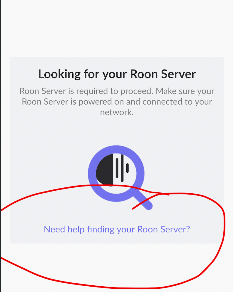

I tried connecting to the Roon service as suggested an again it keeps searching?
All options on both my phone and Mac air keep reflecting the searching screen? Also I scanned the ip address reflected on my Telus connect app and it doesn’t open anything up on safari or google browser.

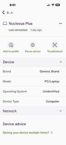

Thanks Alex for getting back to me. I have no switches or vlpn’s in my network. I’ve attached a pic of my Telus network app showing that the Nucleus detected about 1 day ago ( yesterday it reflected the Nucleus about 23 hours ago)? Lastly I hooked up and powered up the Nucleus to my display and it states no signal detected? I tried both hdmi ports. Cheers, Gary

Alex, the unit normally runs cool and I have never really tried any configurations ( usually just default modes). As for the Ethernet lights there’s a green blinking one and a steady yellow or amber on which appears shortly after providing power. Also the power button reflects a white steady light shortly after powering up with out needing to press. When I do press and hold all lights go off.

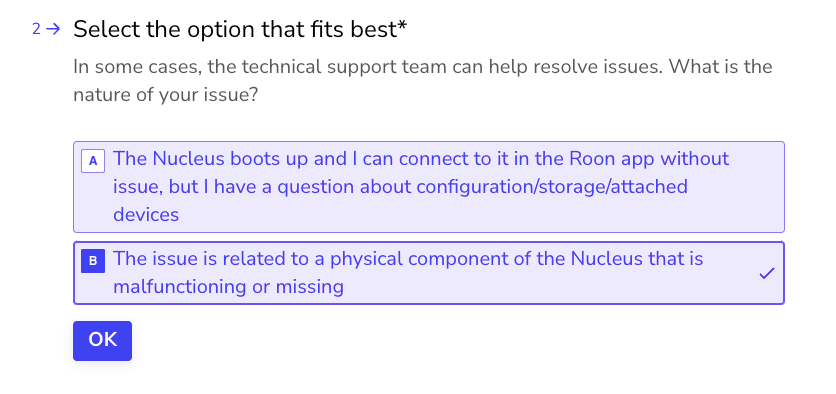

In that case, the best next step would be to contact our RMA team, who handle all hardware-related Nucleus issues.
Please open the Typeform link below and select:
  • Other
  • This issue is related to a physical component
Typeform link: Nucleus Troubleshooting
Once submitted, the RMA team will take it from there.
