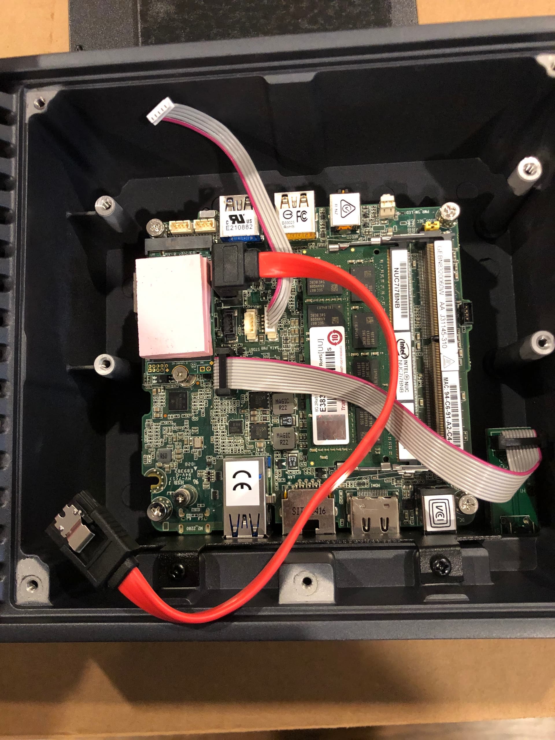

Our apologies for the difficulties you’ve experienced with your Nucleus. Can you please post a screenshot of the inside of your Nucleus? It sounds like you might have storage installed that’s blocking the power reset button that @beka asked you to check.
This is the inside of my Nucleus.
Thank you @Hal_Greene,
I’m touching base with the team for next steps on your issue, I’ll be back in touch as soon as I have more details to share.

I could be wrong, but, from your pic and the reference pic, the reset button is under the drives on the other side of the motherboard.
Does that mean I have to remove the drives to access? Have been reluctant to dismantle it.
Yes. It’s a matter of removing some screws. It’s a trivial, fully reversible process.

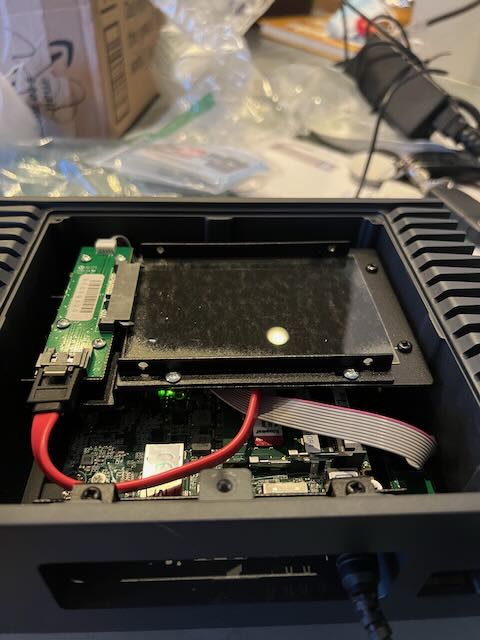

Hi @Hal_Greene ,
Yes, you may need to remove those screws to reveal the power button, first you can remove the silver screws highlighted here in red:
Bring out the SSD connector, and then remove the black screws highlighted here:
And then that will reveal the motherboard with the power switch:
If the power switch doesn’t help, you can try another PSU if you have one, otherwise, the unit will need to be sent in for evaluation at our service center.
I suspect that this is the power button itself or the PSU which has failed, and if we can pinpoint the issue to one of these components, the repair would be easier since we know which component has failed.
If you would rather not perform these hardware checks, we can also ship the unit directly over to our service center, but please do note that since this is a Rev A unit, the warranty has expired and there would be a fee associated with diagnosis/repair.
I was able to press the reset switch but still nada. What is the estimate for diagnosis/repair? Rather than repair a Rev A unit, what kind of trade-in allowance could I get for a more current one?
