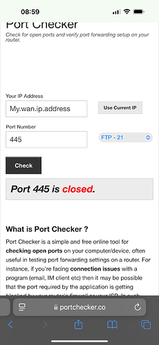

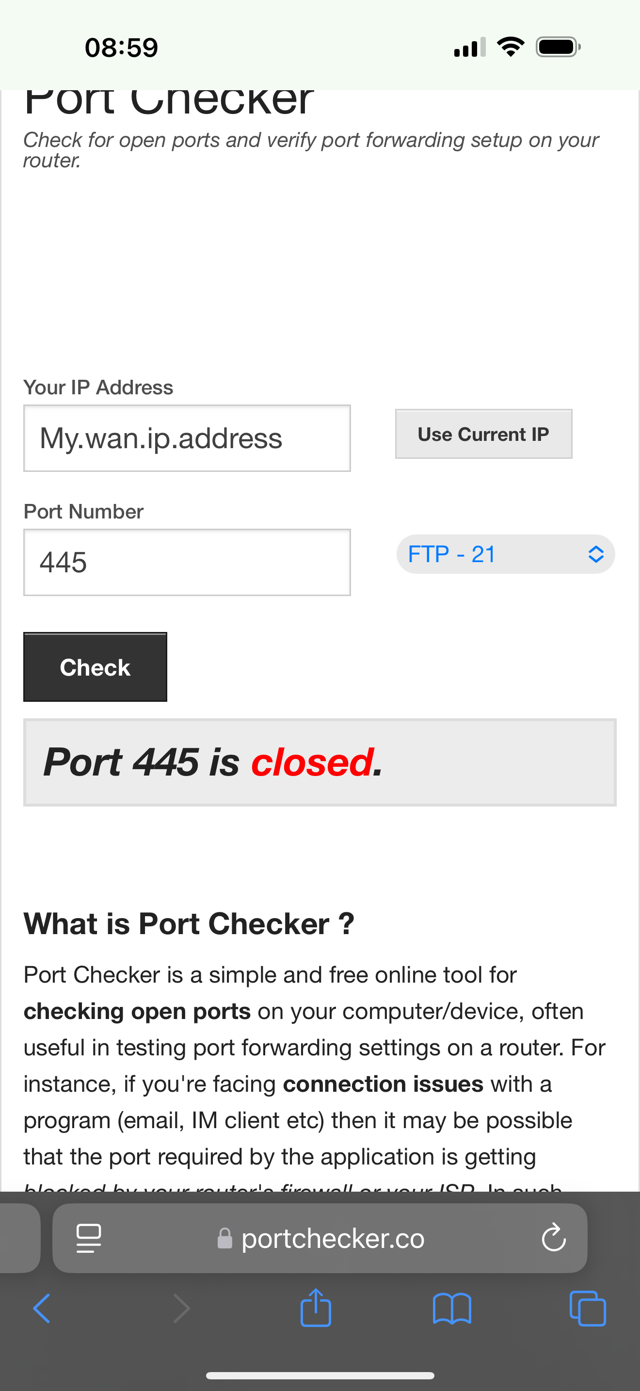

I’d also use the below website to test you WAN IP for any open ports. 139 and 445 would be a starting point.
It’ll detect your WAN IP automatically. Just type or select port numbers to test. You want ‘closed’ to come back.
This helps rule out some things I think
Awesome thank you, that’s v helpful!
Actioning these steps now
Switched off UPnP
Both 139 & 445 came back closed
