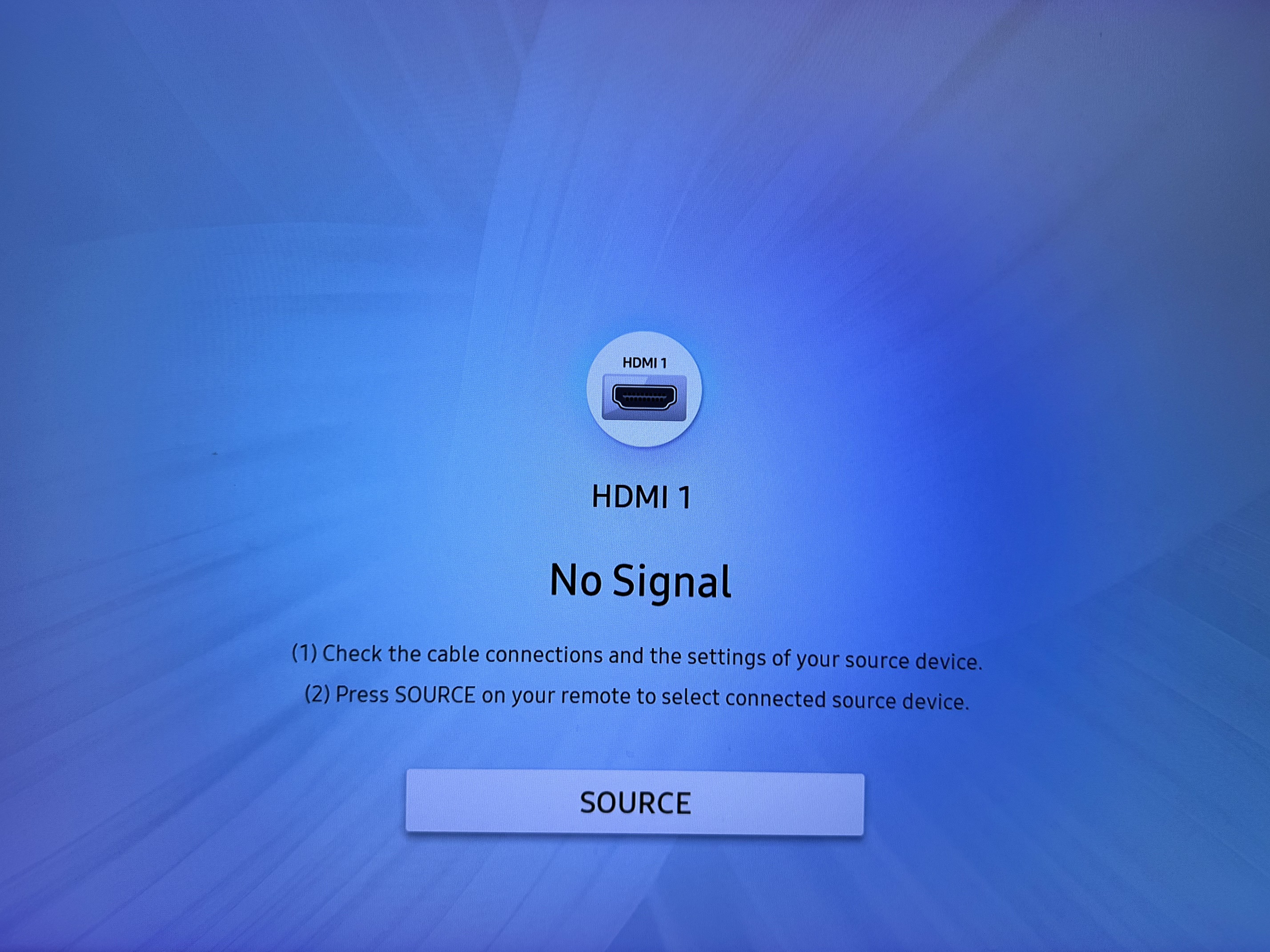

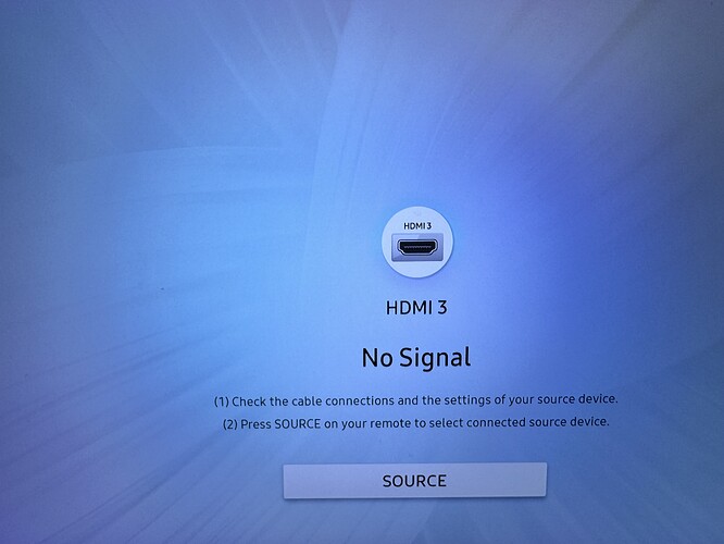

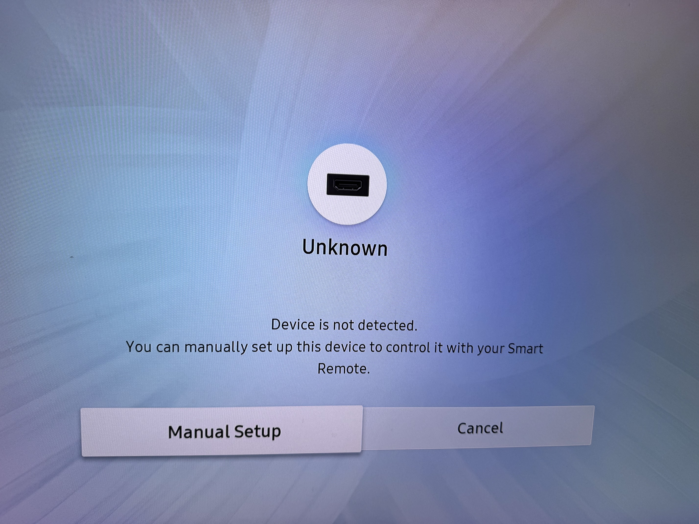

Hi Daniel - Thanks for the assistance! I tried connecting to a tv with more than one hdmi cables and the tv showed both a “no signal” message and “device not detected” message.

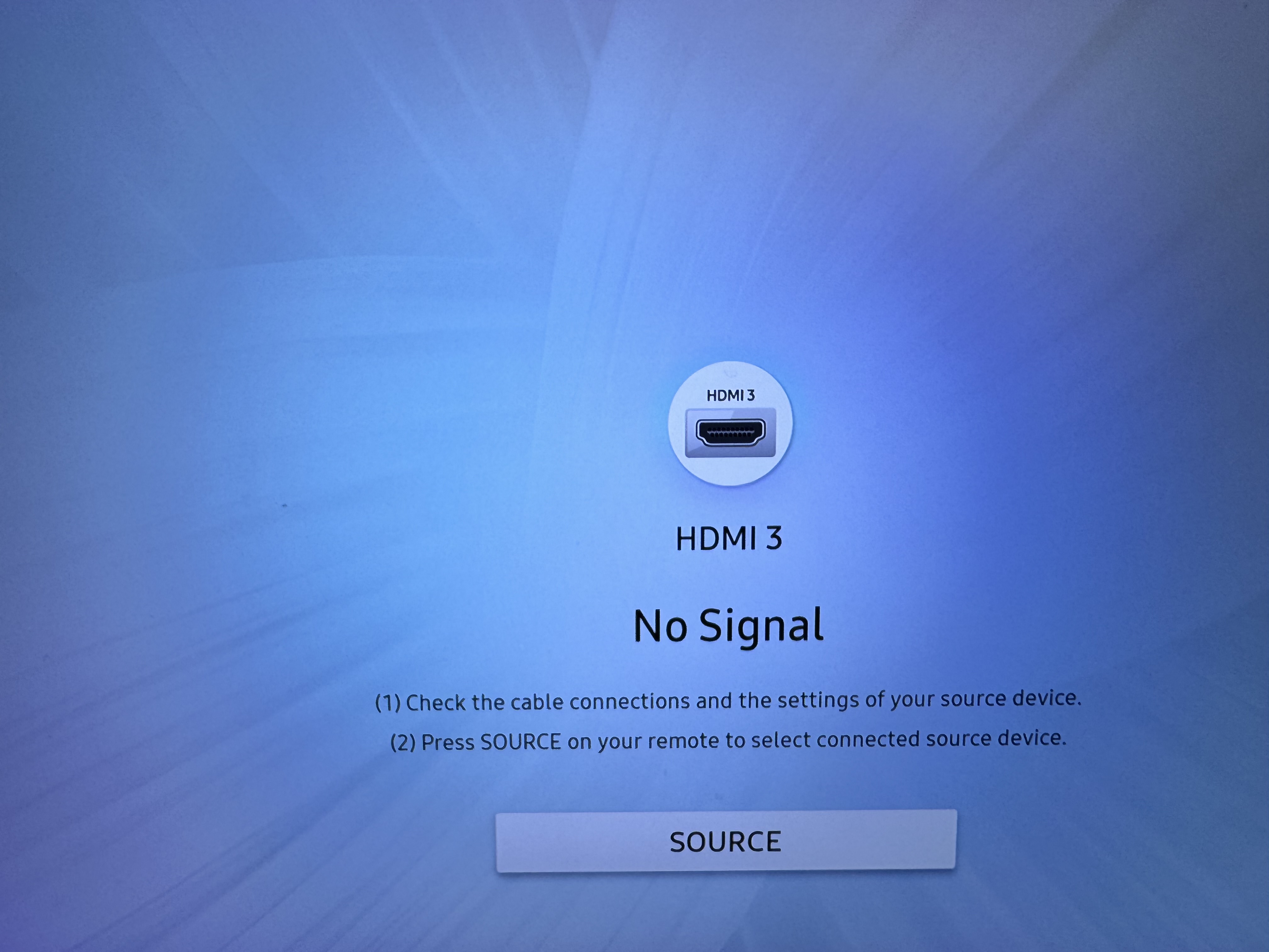

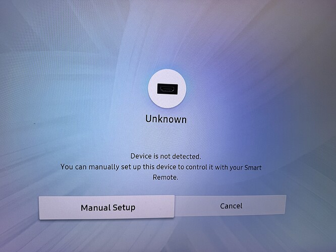

Hi Connor - Yes, it shows the same message on both trials. Thanks in advance.
