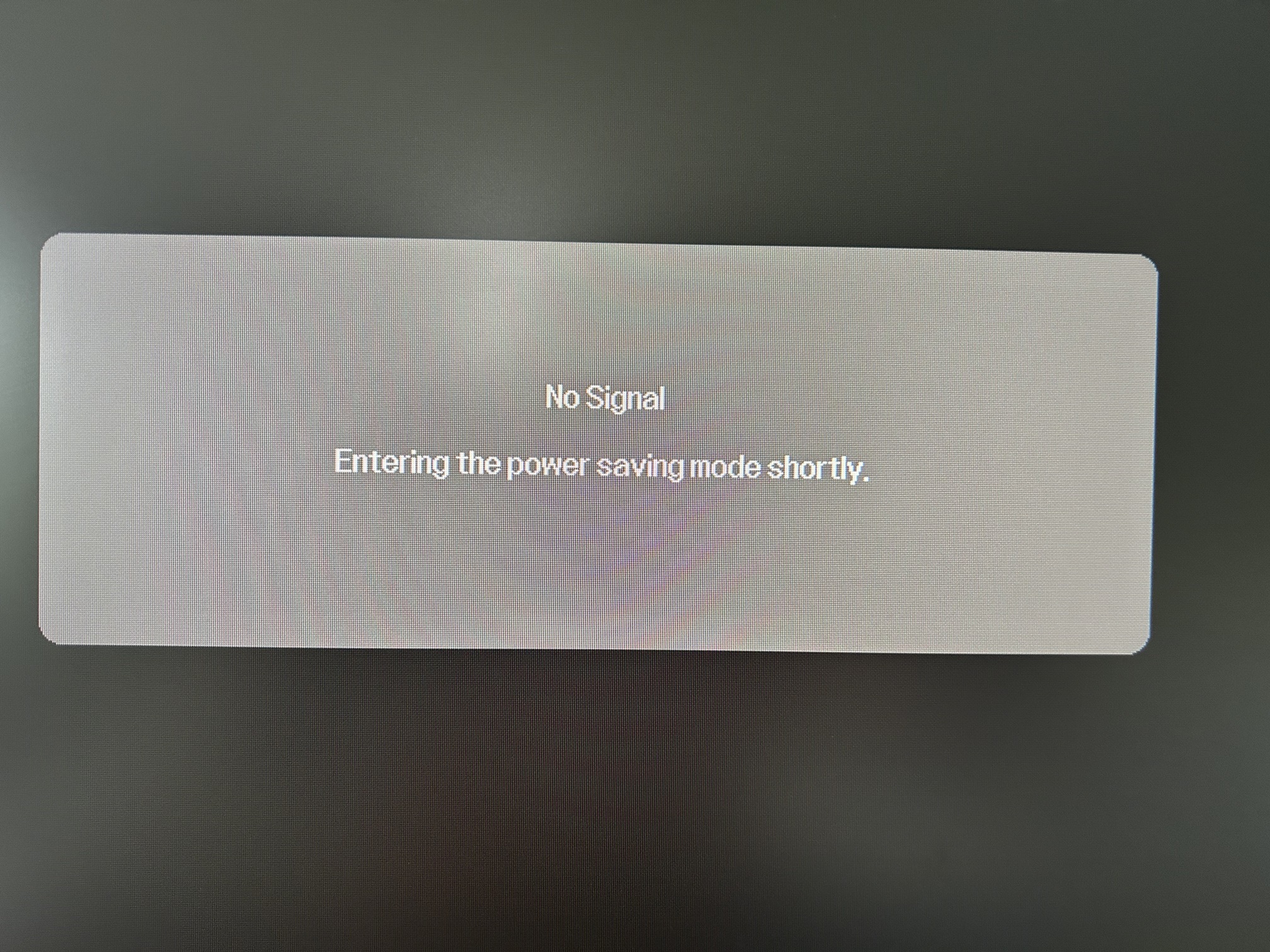

I connected the Nucleus+ to a screen via HDMI (tried ports A and B separately). Nothing shows on my screen, except the attached “No signal” message from the monitor. I appreciate your help thus far! Please advise on next steps.

Based on the photo, it looks like the Nucleus device is not powered up. Do you see any indication that the device is powered on, such as a blinking power button or any other light on the device, aside from the Ethernet indicator?

Hi Vadim,
The device is powered up. The light on the power button is lit.

Hello @2000W
Thanks for the report, and I’m sorry to hear you’ve hit some hardware issues with your Nucleus. The best next step here is to get in touch with our RMA department directly, as they’re in charge of all hardware-related Nucleus issues. To do so, open the Typeform link below and select ‘Other’ followed by 'This issue is related to a physical component".
