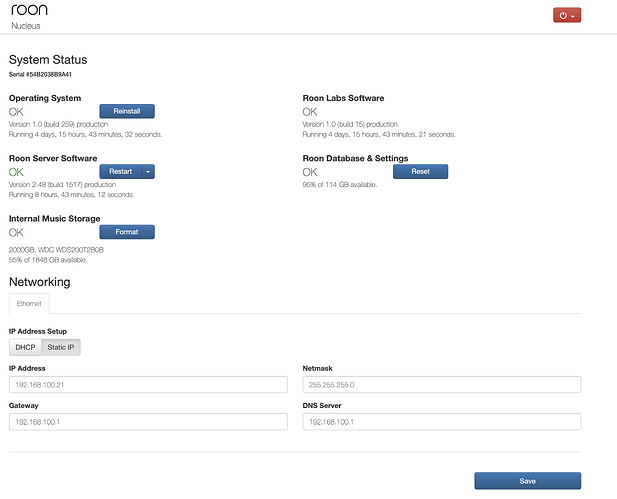

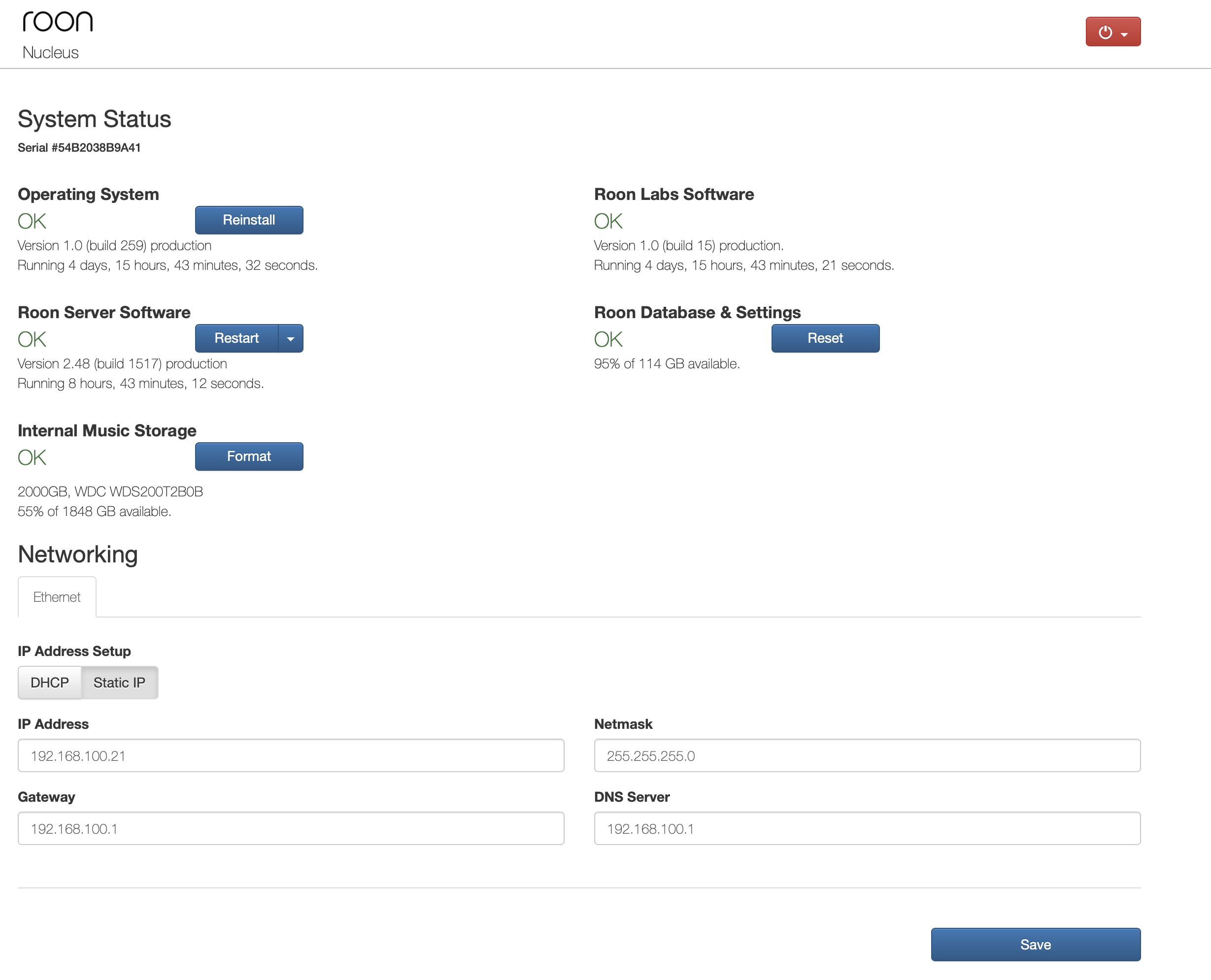

Can you please share a screenshot of the RoonOS Web administration page for this Nucleus? This should contain information about the network interface and also give an indication if there’s any background crashing.

Sorry my late reply. Please find a screenshot of the admin page attached. In between I switched off the IP6 functionality which seems to make it a bit more stable.
The nucleus is directly connected to the router via Audioquest cable.
The router is a Fritz!Box 7590, DSL250 Mbit connected.
