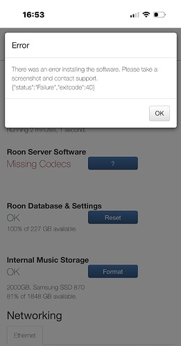

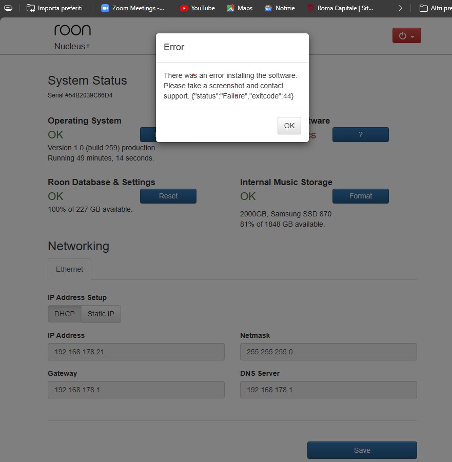

There was an arror installing the software ... failure exit code 44
Nucleus+, 2*LHY-FMC, fritz 5690pro and fritzrepeater 6000
Update: downloaded ffmpeg from the suggested site, unzipped and placed in the codecs directory and restarted the server. Error 44 no longer occurs, the client connects and everything seems to work but on the Nucleus web interface Missing Codecs remains in red in the Server section…
Strange, there was also another case with exitcode 44 and a subsequent codec issue, though that one seems to have been fixed by replacing the codecs.

And now error 40 …
