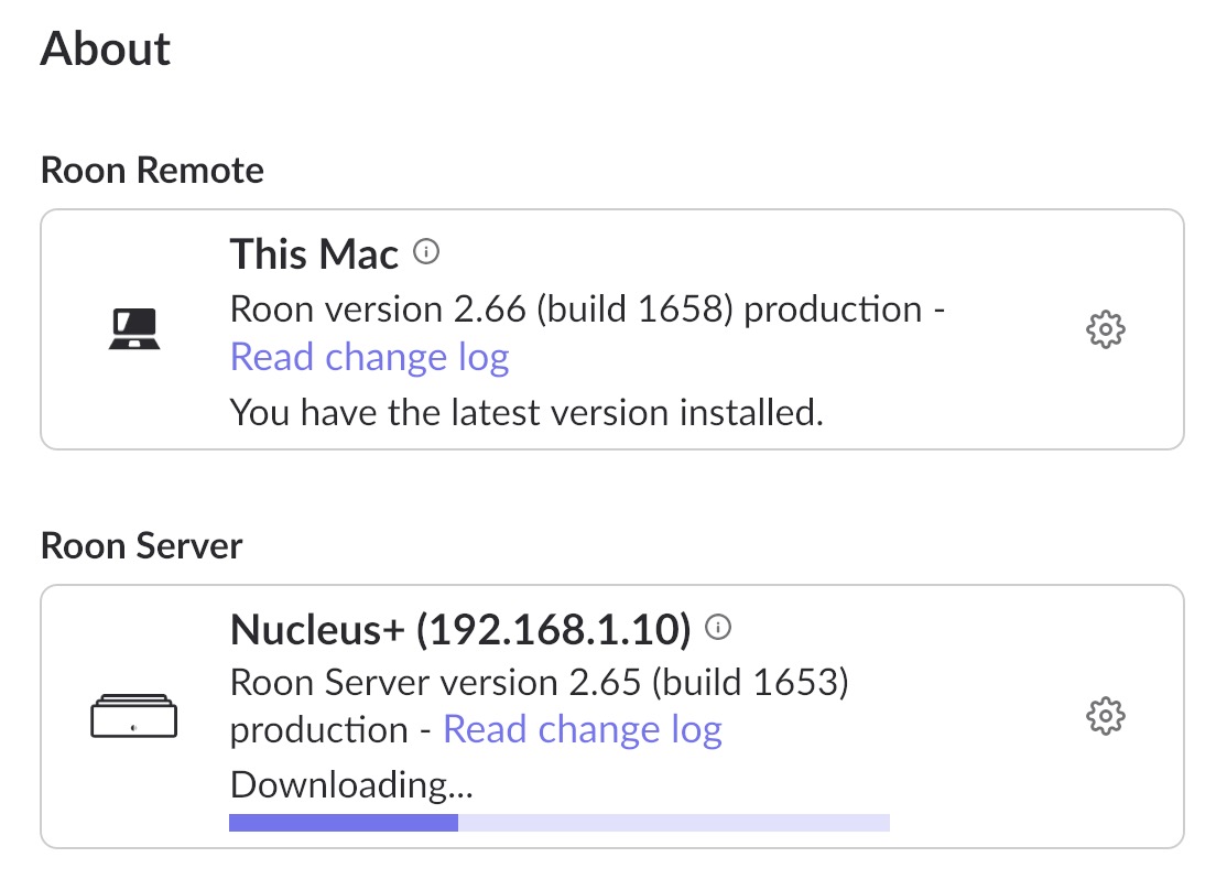

Nucleus+ software update for build 2.66 download stuck at 33% (ref#PCBYJF)
· Software update for build 2.66 not completing download to Nucleus+; download progress bar gets stuck 1/3 of the way through.
· Netgate SG-2100 router, Cisco SG110-16 switch, no VPN

Sounds to me a bit like a possible “no space left” issue. Can you please post a screenshot of your Roon OS Web UI so others can verify that?
