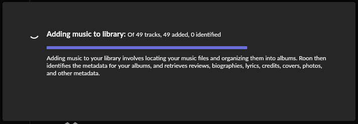

hi benjamin! i am also experiencing this issue. is there any way you can look into what’s causing the trouble? happy to include any logs necessary, but i can’t find the place to attach files. this is what i’m getting:
the rest of my library plays fine. i’ve also done the steps of using the “clean up library” feature, turning off the scheduling window for analyzing tracks, and force restarting both the server and my Nucleus to no avail.

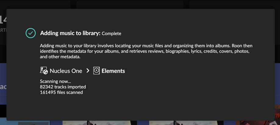

Hi Benjamin - Disabling the storage location and removing all files dated later than April 6th did the trick! I completed a new back up and everything is A-OK. Thank you for your help with this!
