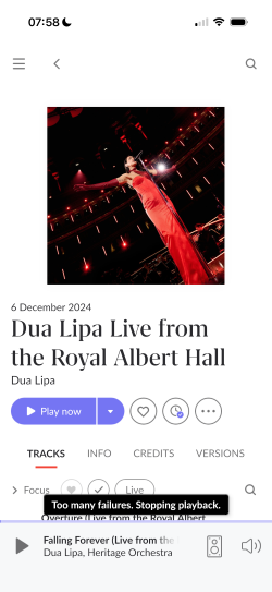

Good afternoon! We have a client that purchased a Roon Nucleus Titan from us and he is experiencing an error when trying to play music from Tidal. The message says "Too many failures. Stopping playback". See attached. Can you please provide me some troubleshooting steps to address this for our client?

Hi @Jonathan_Wesco,
For dealer support, please contact dealersupport@roonlabs.com.
From the users’ admin, it looks like they may be using a free Tidal account, which will not function or play full tracks within Roon - they’ll need a subscription to do so.
Thank you! :folded_hands:
