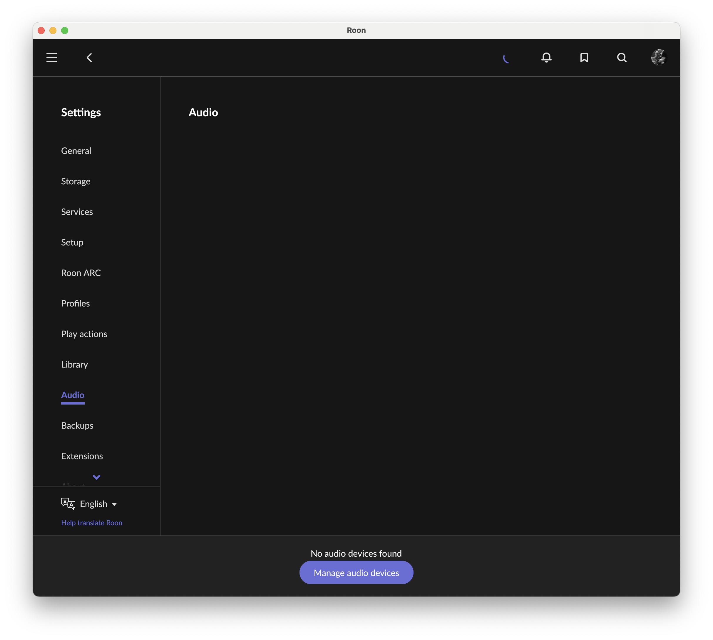

My Nucleus Titan starts, says it can't see any audio devices, then crashes...over and over again.

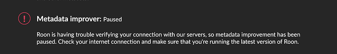

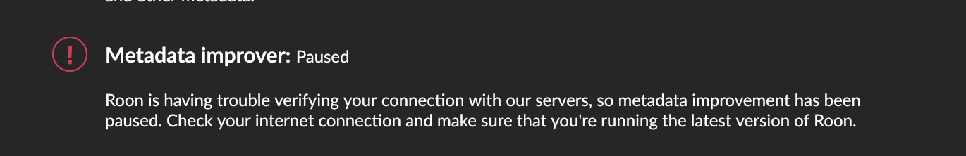

Final update; I restored the database from the version before this one. That restored, could see audio devices, and ran for 10 minutes before failing. Interestingly, I received this in the progress area:
Frustrating…could this all be on your end?

Is there also a hint where it says, on the Titan, that “No audio devices [are] found”, when at the very least, there are outputs on the Titan itself that could be “found”. It’s like something else is failing here, and perhaps that’s the underlying issue?
Note that that happens well before tracks are scanned, so it’d be weird if that was “memory related due to [my] library size”.
