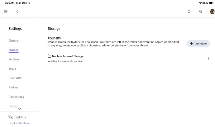

  1. Is your Internal Storage on the Nucleus currently accessible over the network (for example, can you see and browse it from another computer)?
  2. In Roon, under Settings → Storage, does the Internal Storage still appear as connected and enabled?

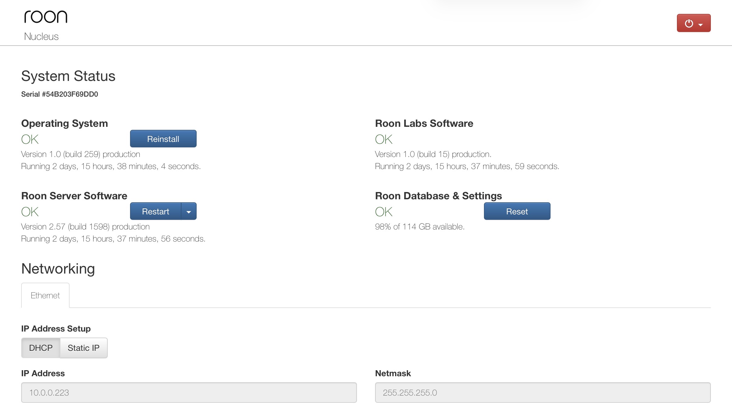

  3. Screenshot of the Nucleus Web UI.

  1. Is your Internal Storage on the Nucleus currently accessible over the network (for example, can you see and browse it from another computer)? NO
  2. In Roon, under Settings → Storage, does the Internal Storage still appear as connected NO and
  1. Screenshot of the Nucleus Web UI.

I unplugged my Nucleus both from the connection on the back of the Nucleus and the power strip for 30 minutes. I also opened the Nucleus and made sure all the SATA connevtions were tight. When I plugged both connections back in the Internal Storage reappeared. So problem solved for now.
My Nucleus thread was as follows: IP Address>Data>Storage>Internal Storage>Roon Imports>Mac_mini> (then all my music files stored on the server). I moved 'Internal Storage" (and the reminder of the thread following it) to right after “Storage”. I think the other thread which included the Mac folder was there because awhike ago pre-Nucleus purchase I used my Mac as my roon server. I think making the thread simpler also helped.
