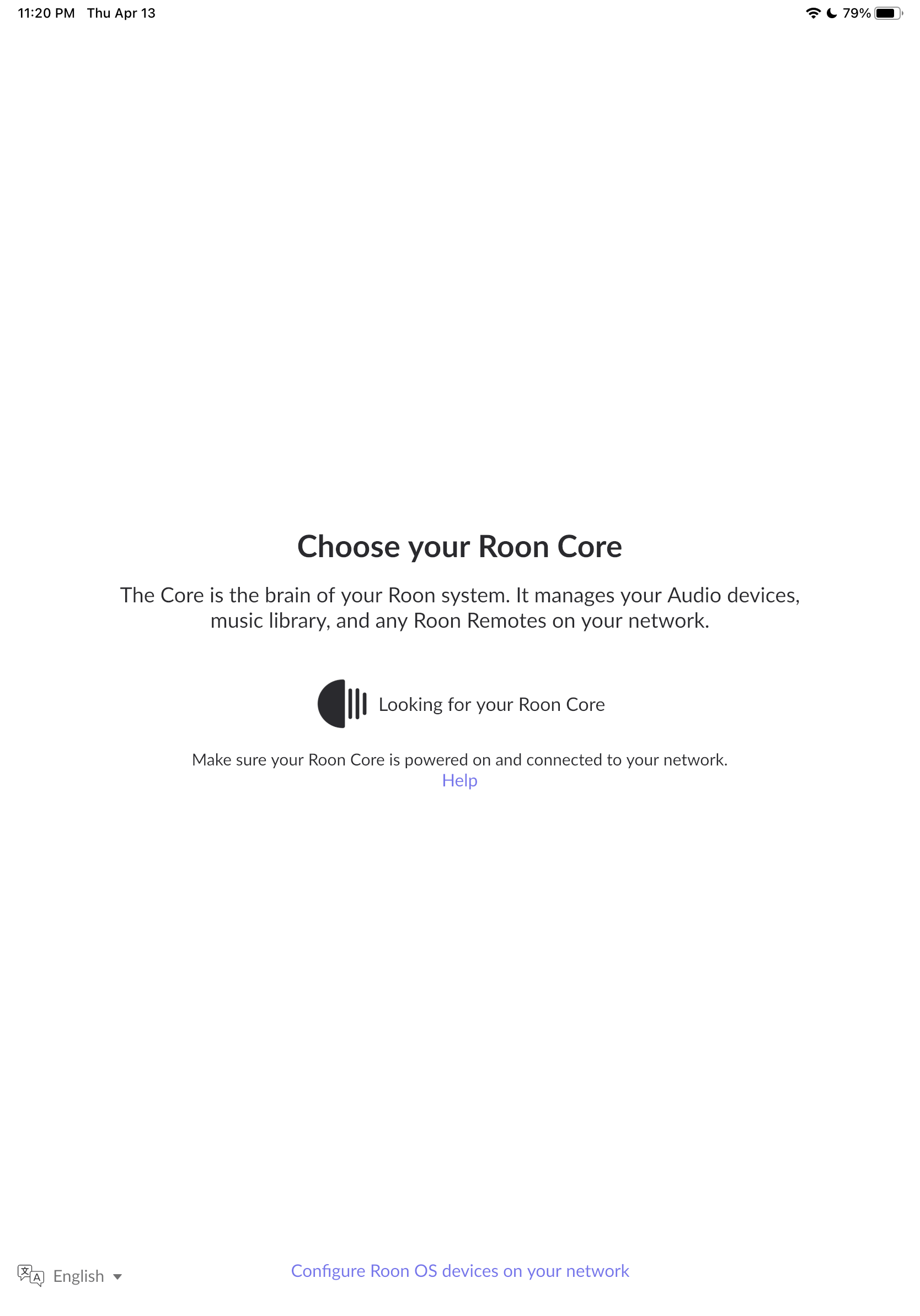

Tonight, “cannot connect to core” message.

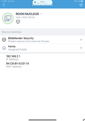

Nucleus seen on Orbi Router (screenshot)
Tried to connect to different core and scan for IP address, no luck (screenshot)

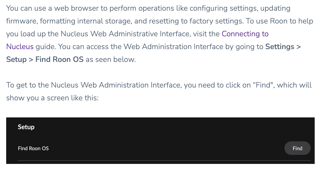

Click on link I provided, it’s all detailed there.
Carl,
Well, I apologize for not being able to follow that. The directions say:
This is done from the Roon App, correct? If so, I cannot get past the following screen on the Roon App:
![Screenshot 2023-04-14 at 1.01.31 PM|690x491]
(upload://j4qBECUD4587M4TdMh8gAuQucpu.png)
If this done from a browser, what URL is used?

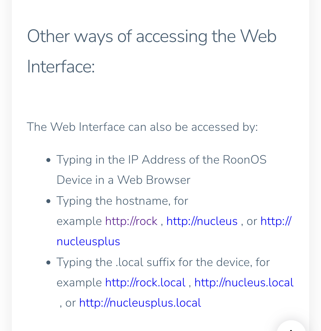

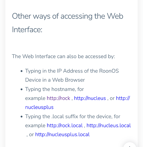

That page is missing the info for doing this simply from a web browser:

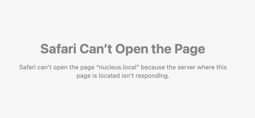

Suedkiez- thanks for that. I tried all of those options without success. Here’s the screenshot of the result:
I’m fairly stuck. Could this be a Nucleus hardware failure?
Possibly, but if the Nucleus is still seen by the Orbi (and if that list isn’t outdated on the Orbi) it seems to be alive.
You did try http://192.168.2.1 ?

So I called them today after taking the obvious troubleshooting steps. The support person spent two or three hours on it and got it resolved. His take, if I understand it properly, is that my Nucleus IP address changed yesterday from xxx.xxx.1.1 to xxx.xxx.2.1. So, Roon could not find it. In a nutshell, he could not get the Nucleus back to a 1.1 address, so he changed the rest of the network and devices to the 2.1 address.
