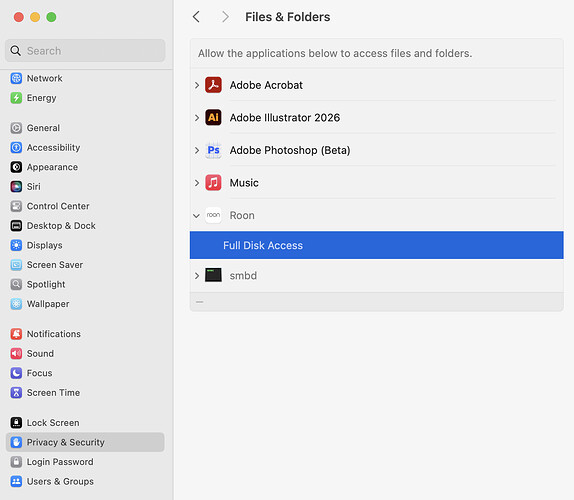

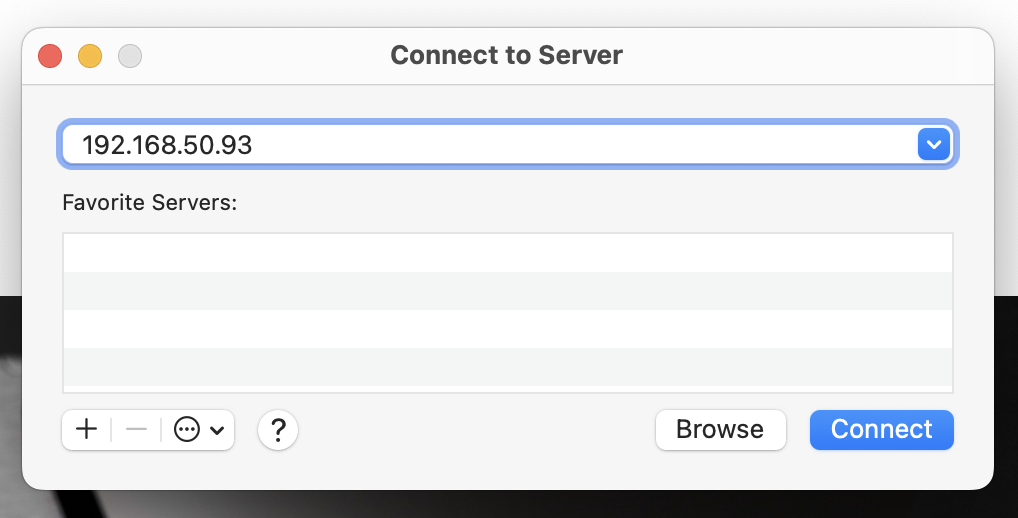

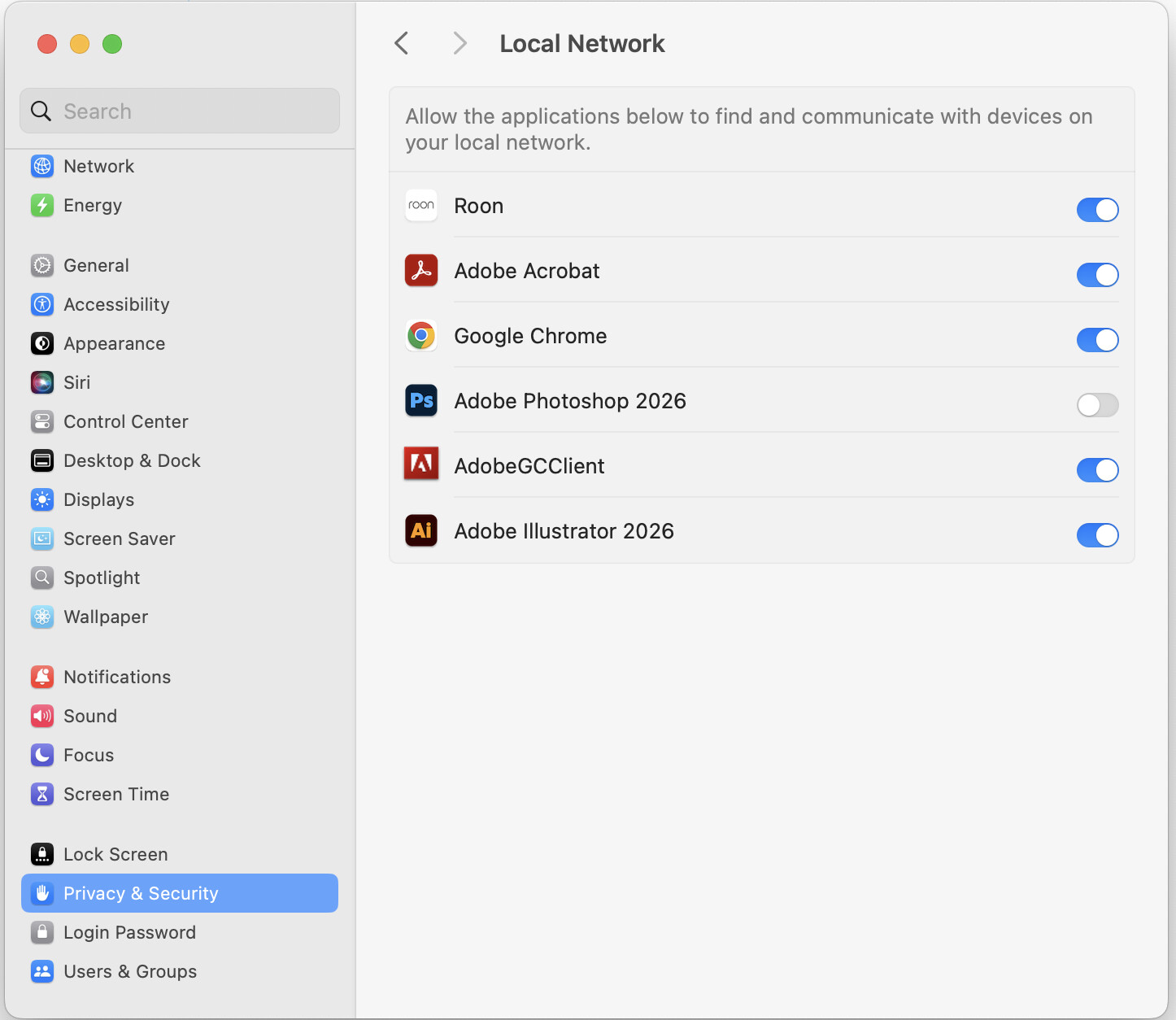

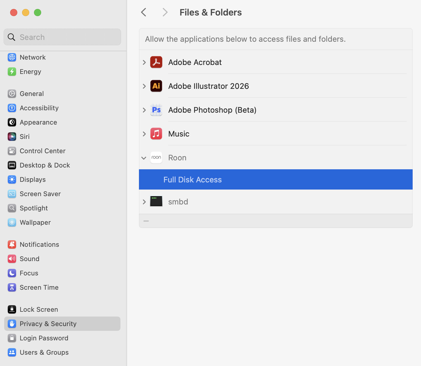

I just uploaded screenshots. The IP address is the address of the Nucleus. I tried using the ethernet IP address but it wouldn’t accept it. BTW I am running MacOS 15.4. The WD drive I’m trying to get Roon to see is connected via USB.

Your screenshots show exactly what is going on, so this should be straightforward.
First, the important bit. 192.168.50.93 is your Nucleus. Your music drive is plugged into your iMac, so that address points at the wrong machine. That alone explains the failures.
Second, the empty folder list in Roon is not a fault. Add Folder only shows storage the Nucleus itself can see: its own internal SSD and anything plugged directly into it. A USB drive hanging off your iMac is invisible to it until you either move the drive or share it over the network.
Third, the two privacy panes you screenshotted do not affect this. Those control the Roon app on your iMac. They do not control what your Nucleus can reach. Please do not spend more time on them.
