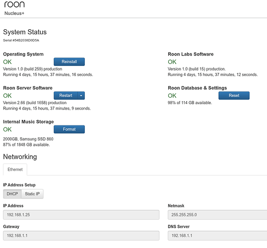

First, please check whether the internal drive is still being mounted and seen normally in the RoonOS WebUI, and confirm whether the music folder on that drive is still added as a watched folder in Roon. If the drive is visible, try opening a few of the affected albums from different artists, and let us know whether the delay or failure happens across the whole library or only certain folders/files.

the internal drive is visible and so to see functioning ok

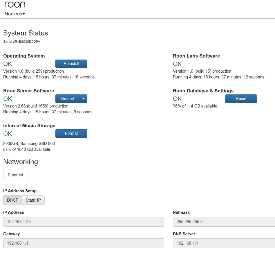

I have some great news. Reviewing your system’s diagnostic data, we can see that your internal SATA SSD is actually completely healthy. There are no physical hardware issues with the drive itself.

  2. Reinstall the OS: Once your music is securely backed up, open the Nucleus Web UI (the same page you shared a screenshot of earlier). In the top section labeled “Operating System”, click the Reinstall button.

On the WebOS page the system status looks fine.

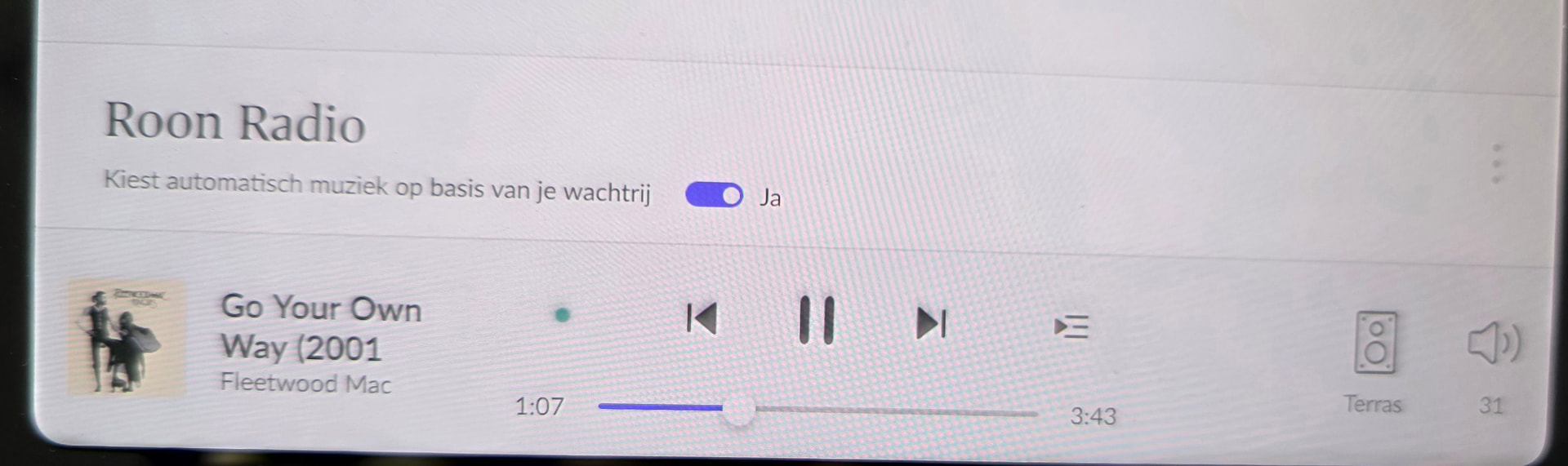

this is the song when Roon stopt playing, even the speakers directly connected with USB stopped playing (turning of like no more signal coming to the speakers)
and afterwards when we got it running again it stopped with everything after a few seconds of playing each song
(everything from the internal storage to Qobuz)
at 9h58 am Brussels time
