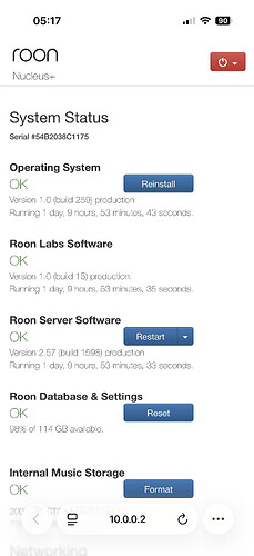

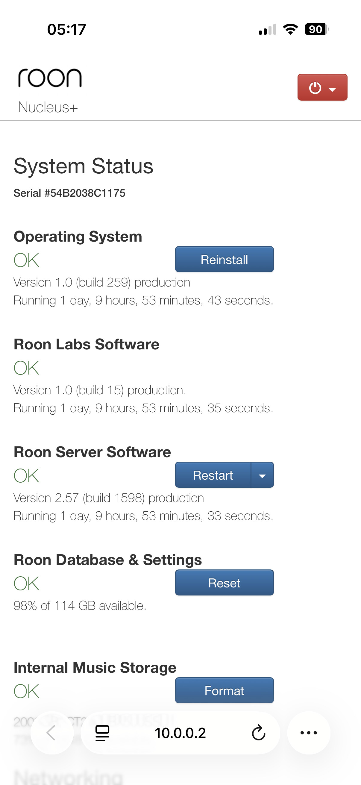

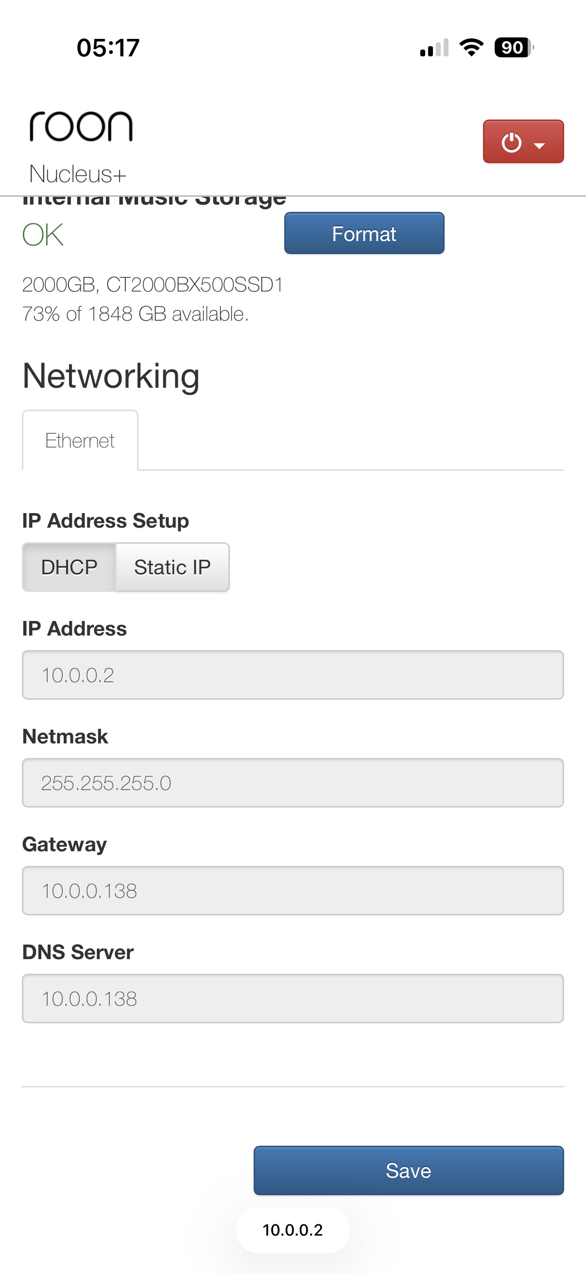

Good Morning. I tried for many many many times to reboot, to Write in networkreset and now nucleus lives again. What do you suggest to prepare now for the case he will die again?
Tanks Alex
