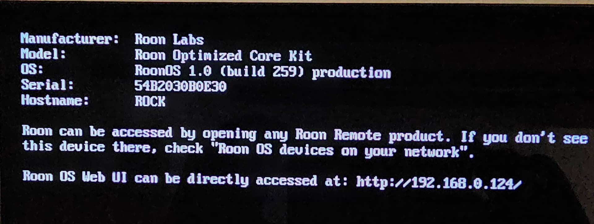

Can you connect a monitor or TV to the HDMI connector on your Nucleus and post a photo of any messages that are displayed? Thanks.
Here you go
You have a Nucleus, but that message is saying that it is a ROCK system - so something is seriously wrong with the m.2 SSD used to hold the Roon OS and the Roon software.
The Support team will follow up with you on the next steps. From your first post, I suspect that the Nucleus is out of its two-year warranty period, so your cheapest and best option would be to replace the m.2 SSD yourself, install ROCK on it, and then ask the Support team to upgrade the ROCK version of Roon OS to the full Nucleus version (they can do this remotely).

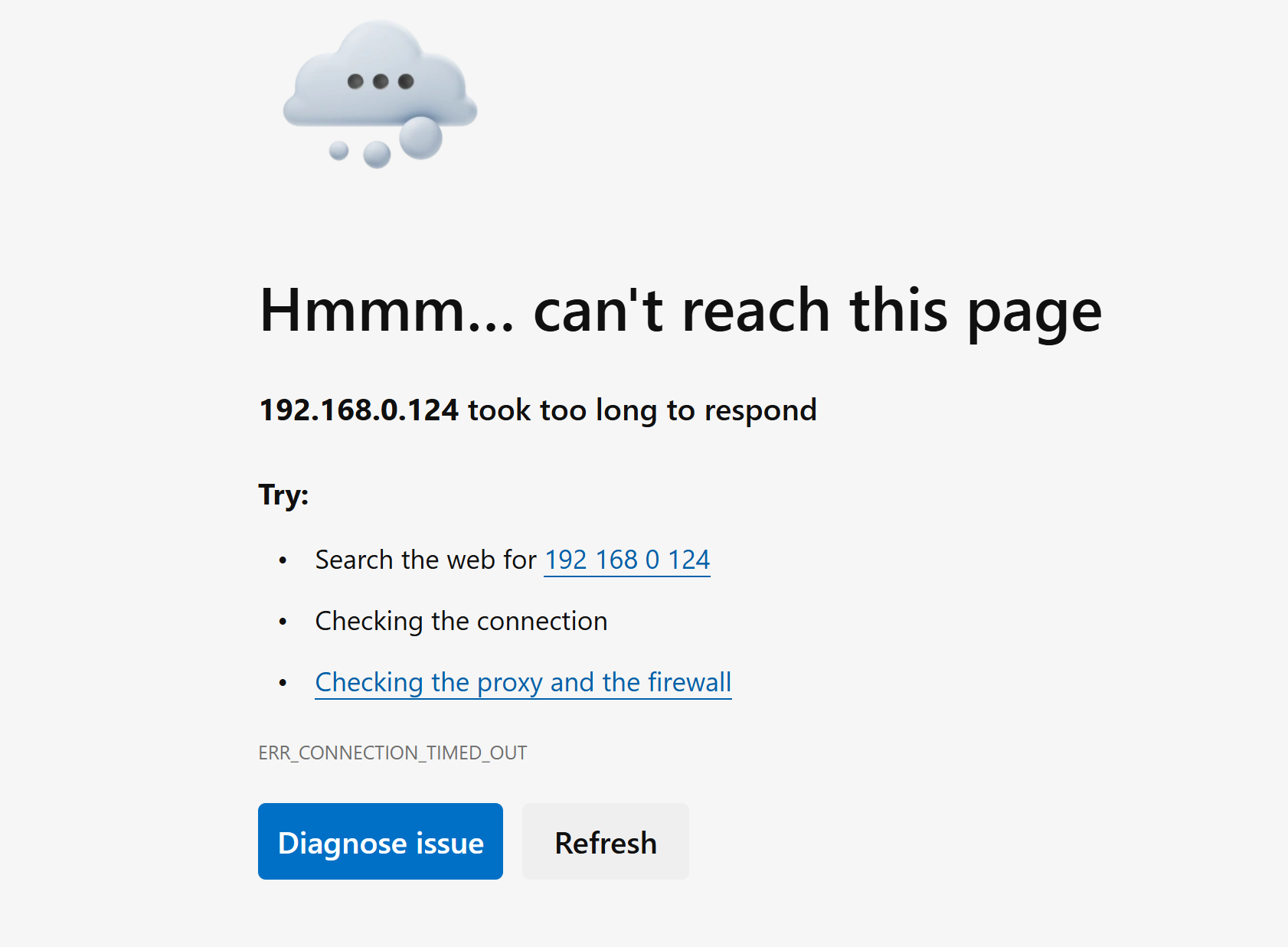

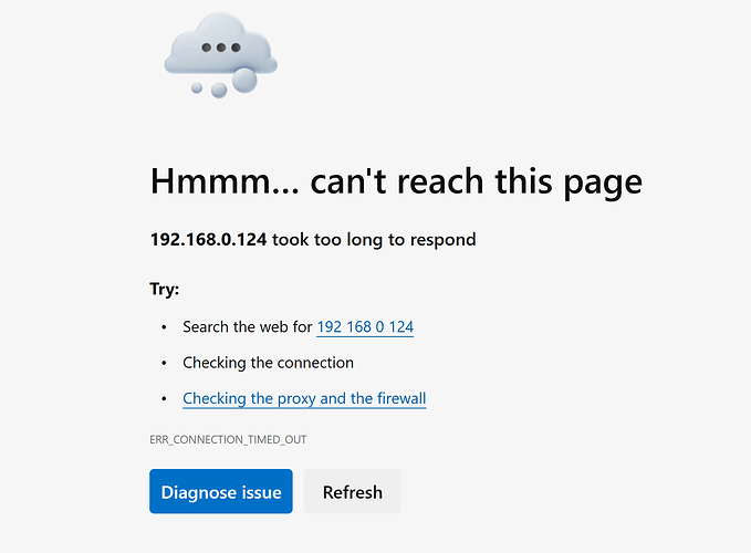

The photo of the Nucleus screen that you posted earlier was showing that the IP address of the Nucleus is 192.168.0.124
To access the Web Administration Interface, type http://192.168.0.124 (or click this link) into the web browser of your Windows PC and post a screenshot of the result…
It’s not connecting:
Thanks - it definitely looks as though the m.2 SSD is faulty. The Support team will follow up with you (possibly via PM).
