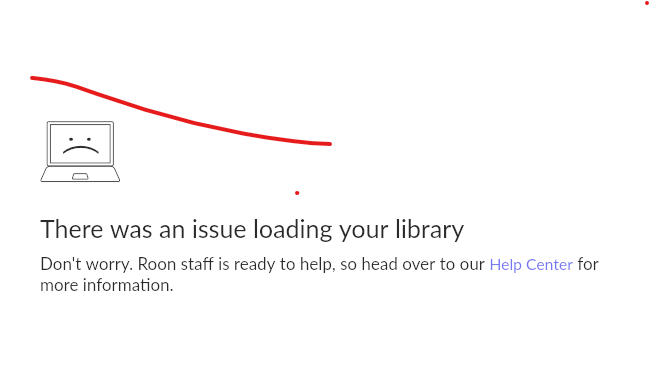

I have a brand new Nucleus 1. I attempted to load a database saved from my former Roon server (a PC) and after several minutes it responded that it couldn't connect to the database. Now when I reboot the Nucleus, it simply keeps taking me back to the same "unable to load database" message.
