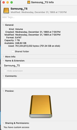

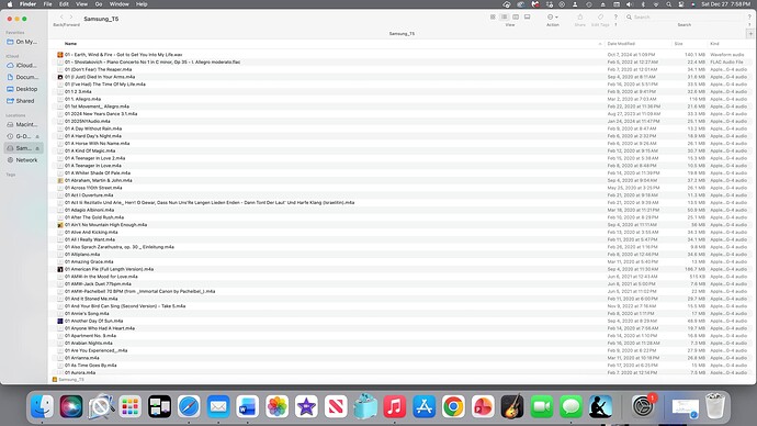

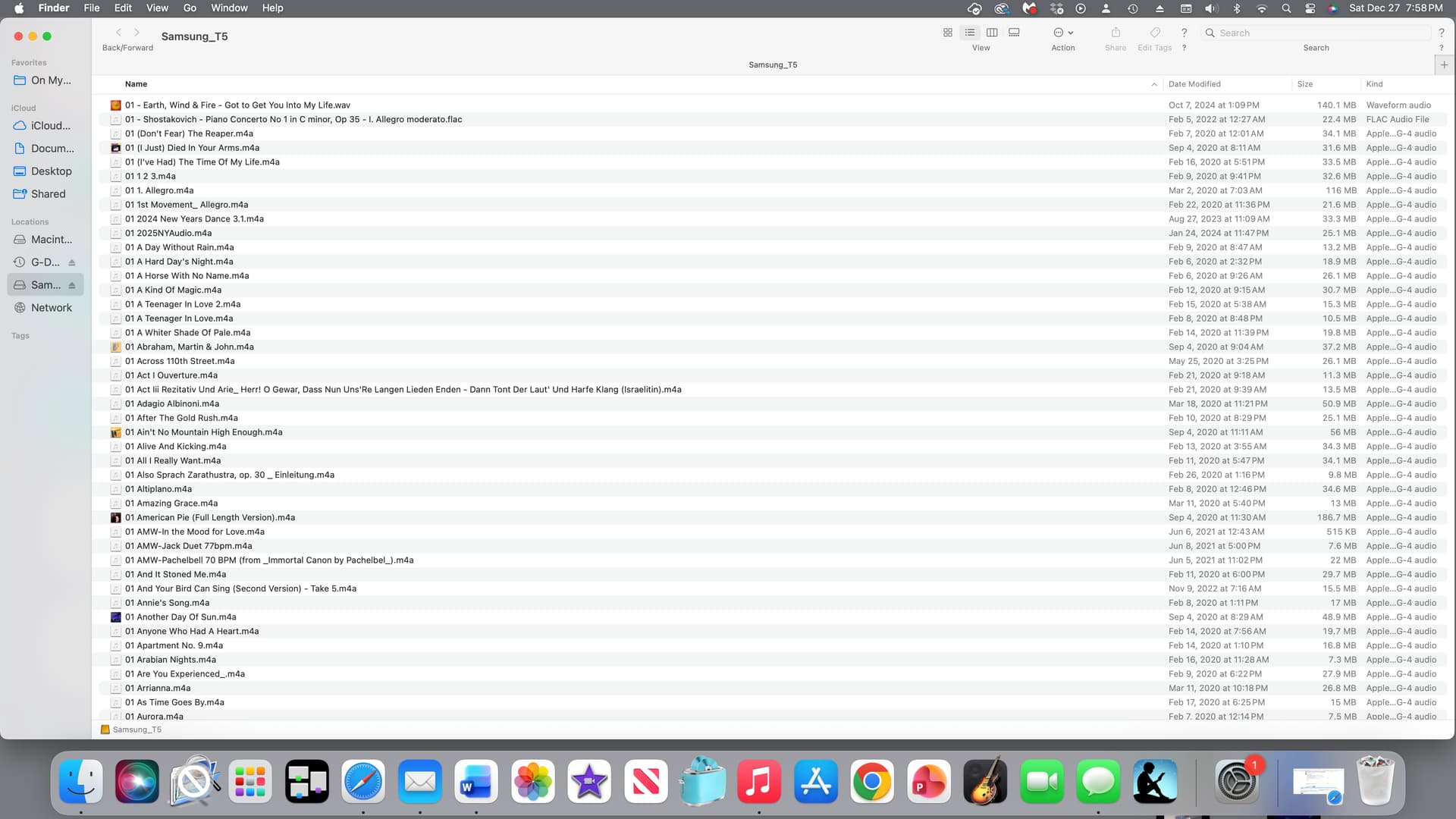

I’m afraid you’ll have to explain your suggestion like you were talking to a kindergartener. I don’t know how to check hierarchies, and I’m not even sure what you mean by “reset” the Nucleus. Turn it off and on? Hold the button in? I’ve added screen shots showing some of the songs contained in the T5 as well as the info page.

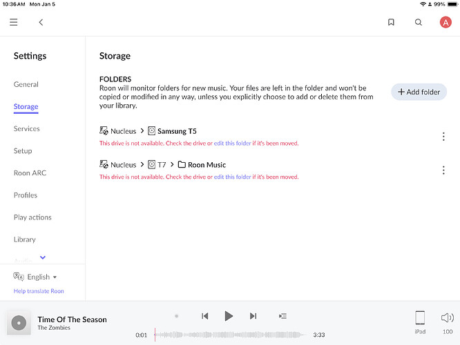

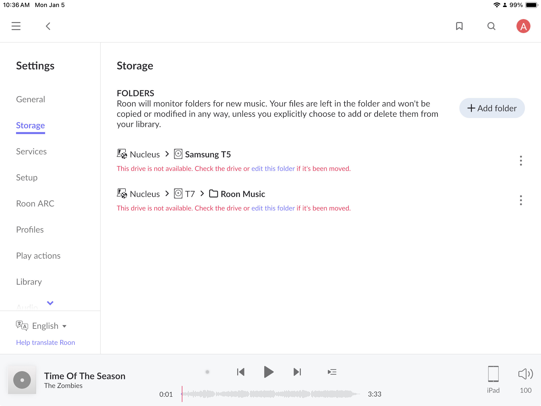

Would you kindly share the screenshot from the Settings → Storage?

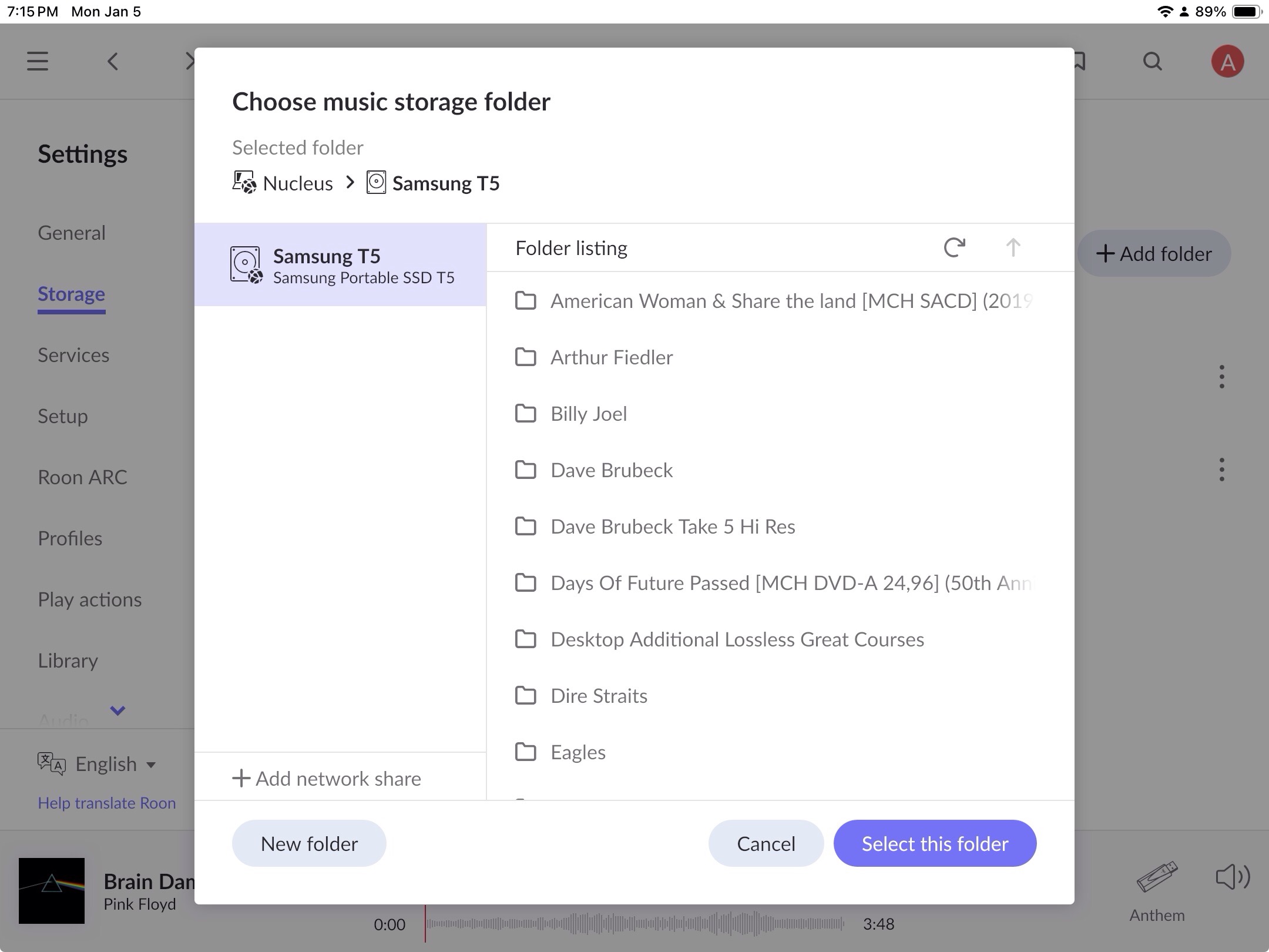

Hi @Alan_Wishnoff,

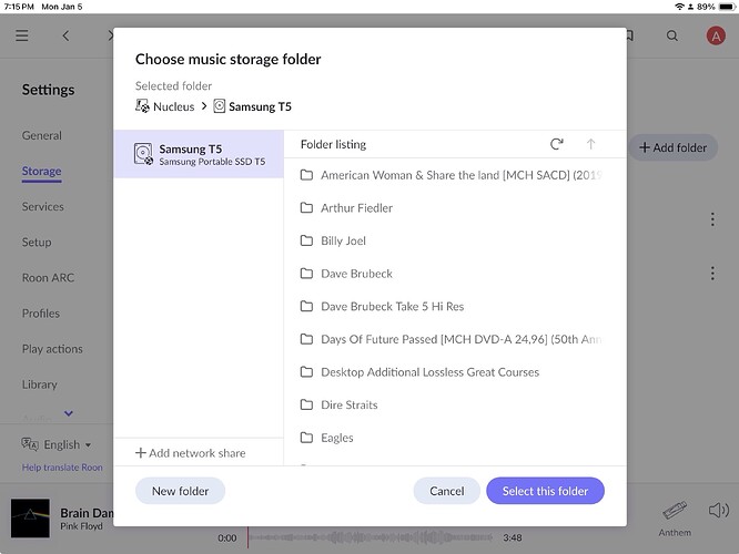

Thanks for this! And, if you select the +Add Folder option, do you see your attached T5 drive? You don’t have to select it, but a screenshot showing if it’s available is what we’re interested in.
Thank you!
Here it is. As you can see, the Nucleus does appear to recognize the T5.
Hey @Alan_Wishnoff,
That’s good news! Now, our follow-up question:
Since the T5 is only hosting a backup of your library, what is your goal with connecting it as a watched folder?
Thank you!
My goal is simply to confirm that my backup library on the T5 will work, i.e. be recognized by the Nucleus, should it ever be needed.
