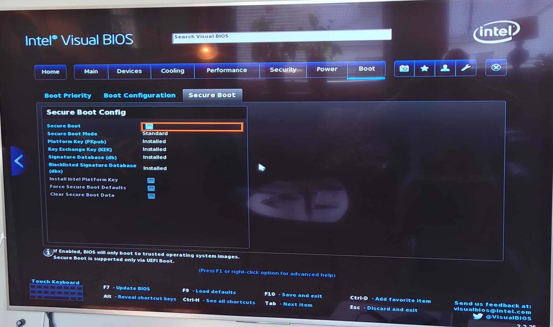

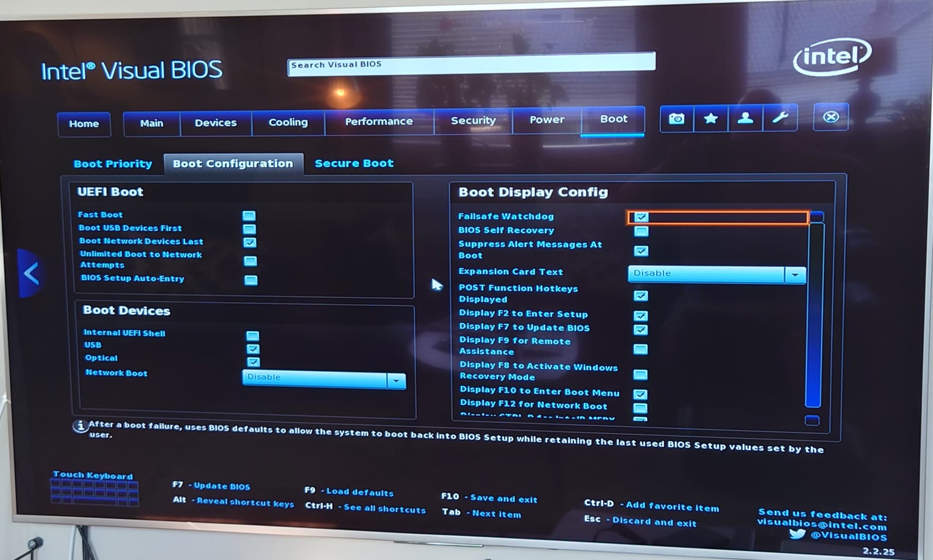

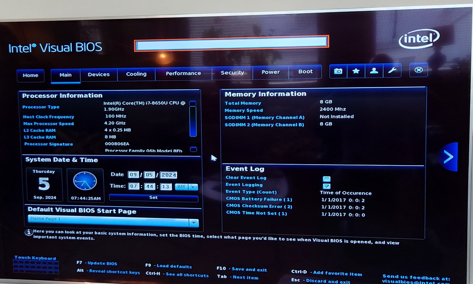

Would appreciate if you could confirm that the following (5 out of 8 pics) BIOS settings are OK.
Thanks.

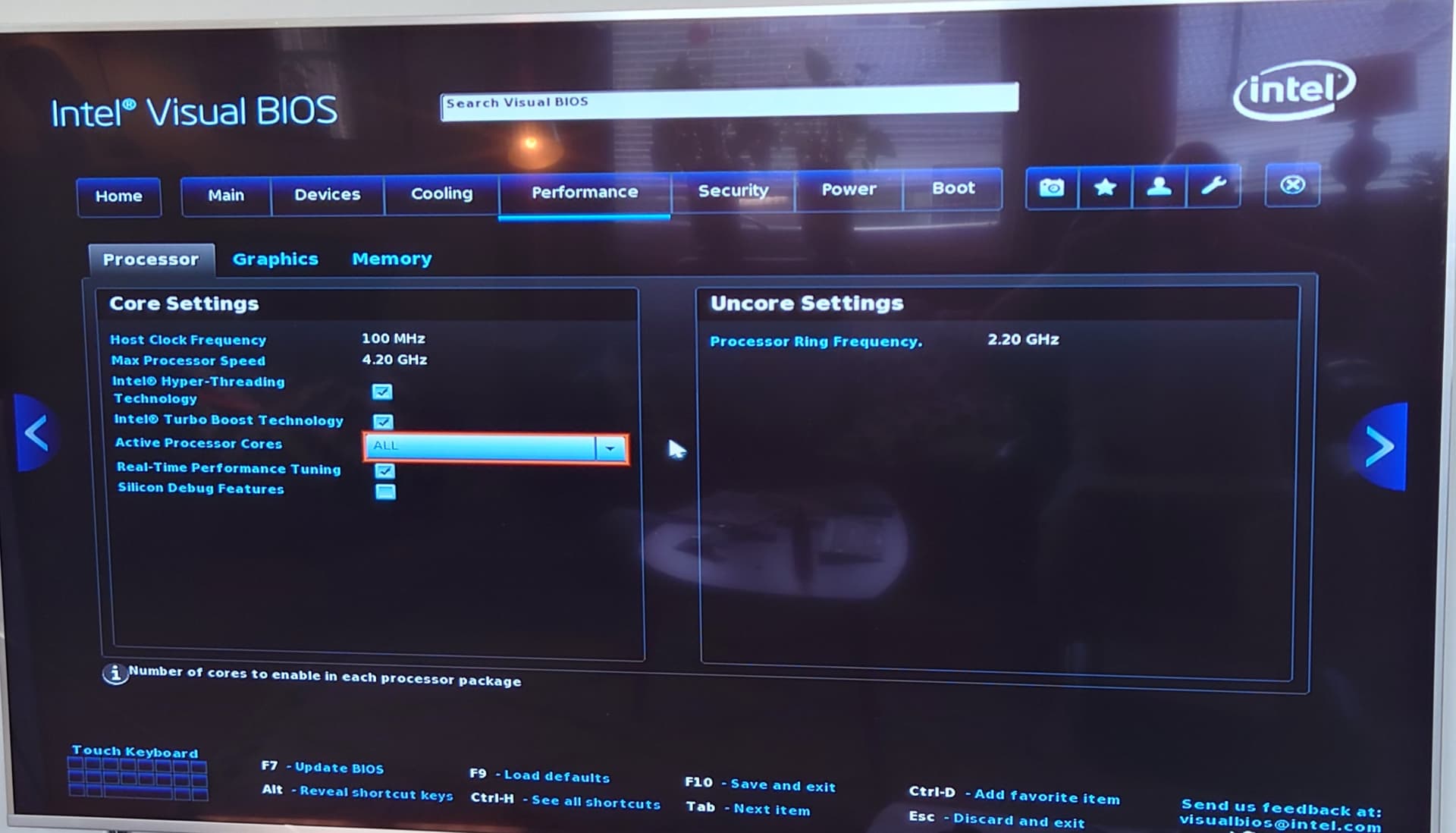

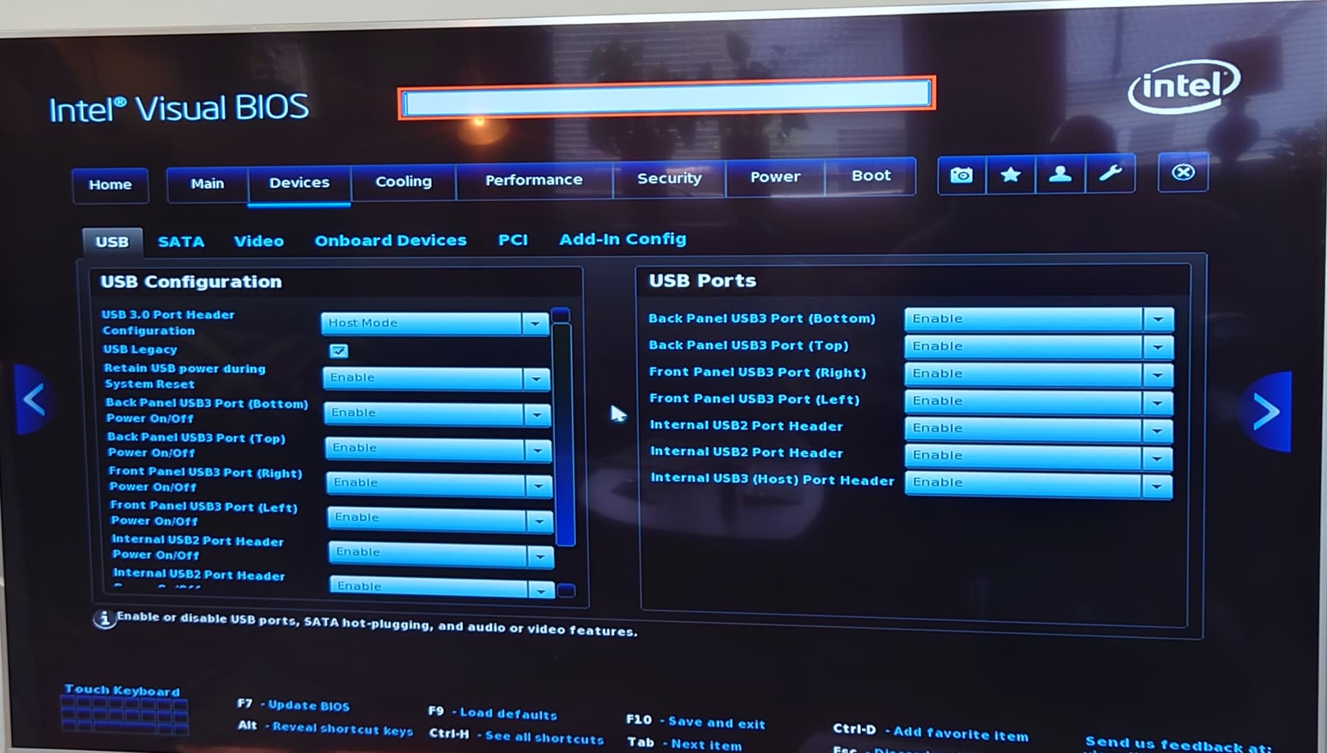

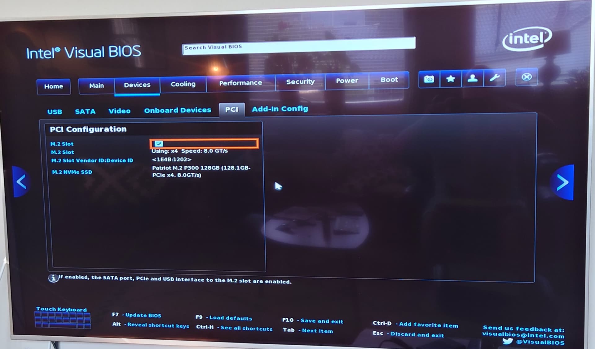

the remaining 3 pictures
Any suggested path forward?

You typically don’t need to touch BIOS settings when updating the internal SSD. As long as you have the SSD properly inserted with ROCK installed, you’re in good shape.
