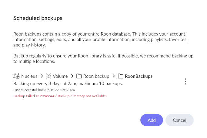

Can you please post a screenshot of Roon’s :gear: > Backups > Scheduled backups > View screen so that we can see exactly where you are storing your backups? Thanks.
Thanks for the quick feedback. Please consider that all my music is being stored on that volume, which is not availabel for backup but for playback. Isn´t that strange. Here is the screenshot as requested.
grafik
You should never backup the database to an internal storage location on a Nucleus, not the OS drive nor the storage drive. You need to backup to an external USB attached storage device or a network location.
Backing up to the OS drive will loose the backups every update and backing up to the storage drive will have Roon scanning the backup files and possibly corrupting the database.
Hi Big Dan, thanks for the instruction :+1:Upon your reply, I checked my Nucleus again and found an USB-Stick attached to it, which acted as the Backup Volume. For whatever reason this stick had a problem. Repairing it on a Windows PC made it visible again for the Nucleus and ready for Backup or Restore. Thanks so much and have a great day.
