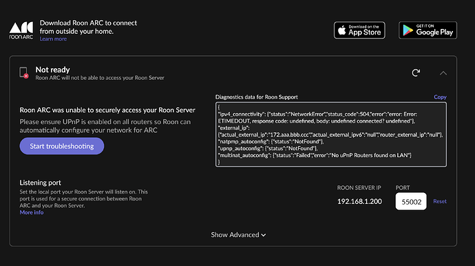

Thanks. well, I installed Tailscale because port forwarding some days worked some days did not. ARC is a little bit flimsy compared to Plexamp, for example, which just works. But I want to have a reliable ARC as all my music is on Roon and many playlists which I have to duplicate inside Plex to access them from the car. Taislcale was supposed to solve all problems but now it seems it does not. Asking your customers to deal with port forwarding and editing settings in routers is too much. I can do it; I worked for Cisco 7 years. I can build my own amplifiers. But it should not be that way. It should work easily. ARC is a source of frustration for a lot of people, me included. I love Roon and I will keep using. But ARC is a pain. I just re activated the port forwarding to both 55003 and 55002 and it does not work.AT least with Tailscale can connect to the Nucleusone…If you can help I will

Thanks. This makes sense. Now I can try and set port forward for both WAN connections. But if I want to keep Tailscale, how can i make that the router ensure that all WireGuard packets continue to exit through the same ISP that established the original session.? Thanks in advance
