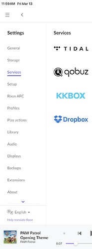

Nugs not appearing in Roon services list (ref#CUSKPR)
· Nugs is not listed in Roon services
· Router TP Link working all good

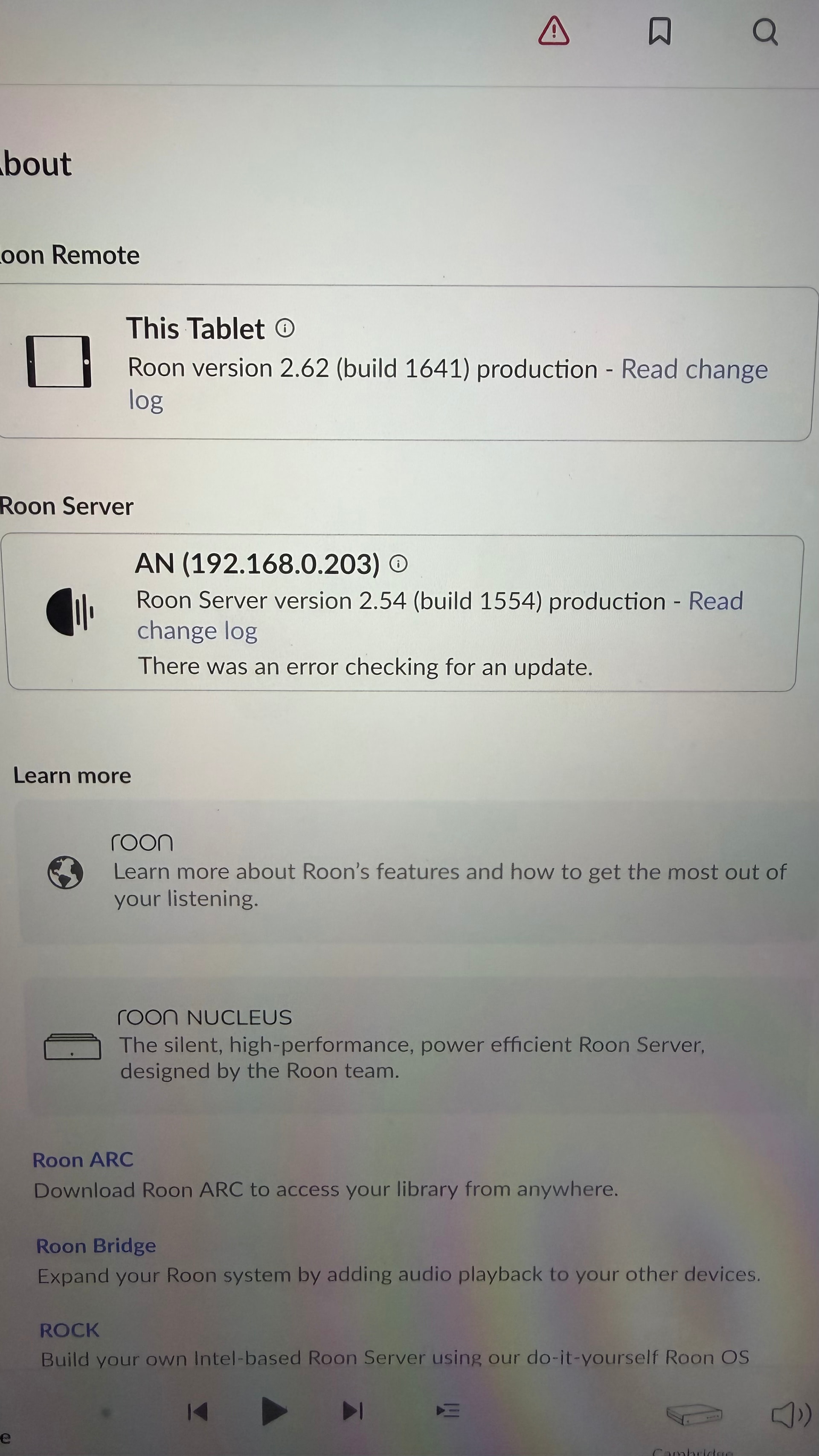

Roon App running is the latest version 2.62 (build 1641)
Roon server version is 2.54 (build 1554). Don’t know if there’s a latest since every time I check for server updates I get “there was an error checking for an update” but don’t get the error nor if there is a newer version
It’s not, see the linked post shared for details.
This is the real issue, once updated you will see nugs.
Typically this error manifests when the Roon Server cannot communicate with Roon’s update services.

Hi @Diego_Fernandez,
Thanks for writing in and for sharing your report! The failure to update is definitely the crutch of your issue here.
From a fresh Roon Server diagnostic report, we see he Roon updater has successfully downloaded the new files (as seen in your logs reaching 80%+) but lacks the authority to overwrite the old files in your /Applications folder or the ~/Library/Roon directory.
Can you check to see if Roon Server has full disk access?
macOS has become very strict about apps modifying files. If Roon doesn’t have the right permissions, the update will fail when it tries to swap the old version for the new one.
