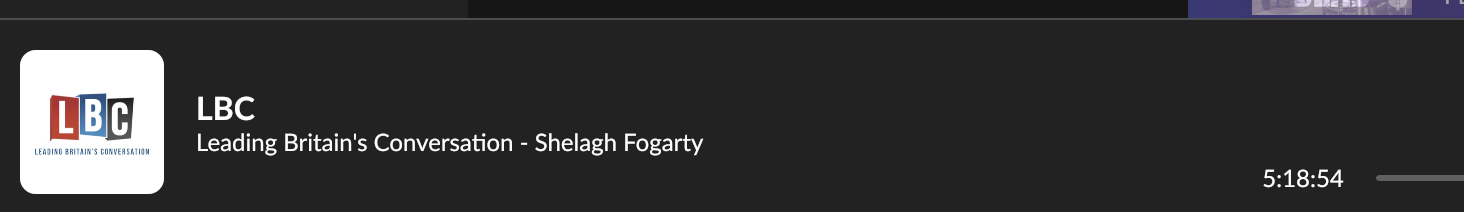

Bit of a scare this morning after an unexpected Eero update (the 2nd in 48 hrs!) wouldn’t play for more than 10 seconds… Quick reboot of ROCK though, and it’s been solid ever since, 5 hrs and counting, which is definitely a record.
