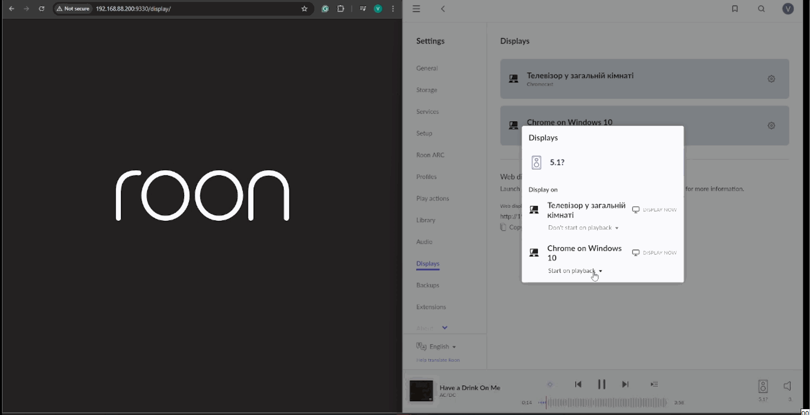

It’s been some time since we last spoke, so I wanted to check in with you here, are you still seeing this same issue? Note, to enable the iPad as a display zone, you would need to click on your Volume → Display Icon → Start Display. Do you see this option on your end?

I suspect you may not have properly started the Roon display functionality, you mentioned seeing just the Roon logo, but for it to display anything, it must be started as a display zone via the Volume icon while music is playing:
Starting display2
