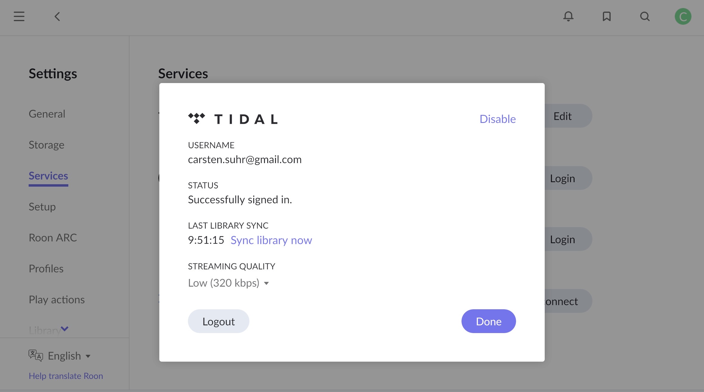

Besides changing sound quality to low for Tidal I have also done this without any effect on the dropouts when is play songs from Roon.

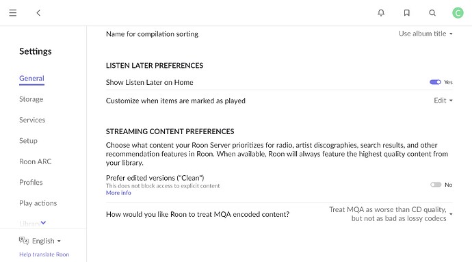

Streaming content preferences has also been reduced without any effect on the dropouts:

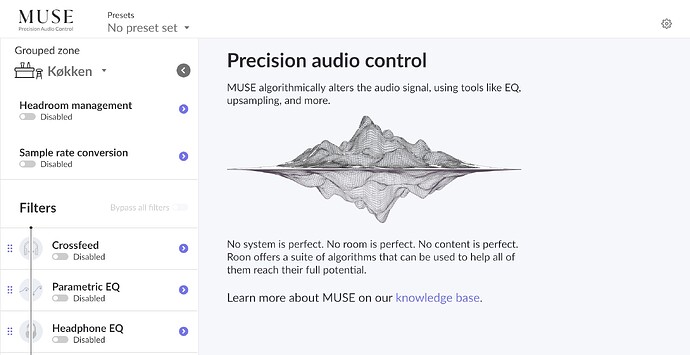

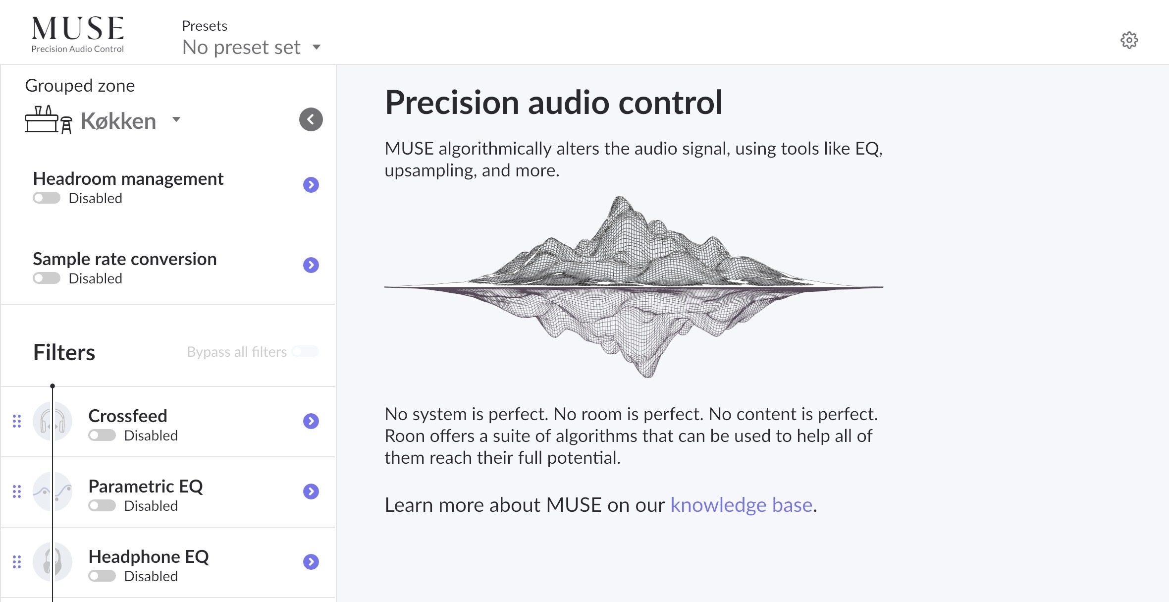

I do not use any filters that might also require extra performance from Roon:
