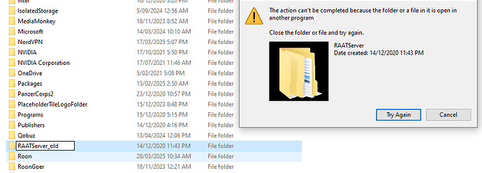

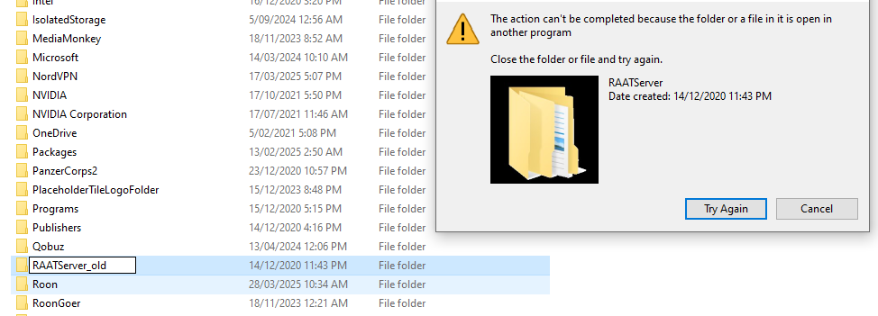

Hi. I’m unable to modify the RAATServer file.
I can’t see where the file or folder is open in another program…
Hi Again. As I can’t seem to refresh the RAATServer is there any purpose in trying something? What would happen if I could just delete that folder?

Based on your screenshot, Roon is likely still running, and therefore you’re unable to edit the folder. Make sure you’ve closed all instances of Roon and Roon Server on the machine before attempting to rename the folder.

Hi Is it possible for you to see the path where Roon is still running? If you can show me that then I may be able to turn it off. Thanks.
@Mark_Maddison can you open Windows’ Task Manager and manually stop all Roon and RAAT applications and then re-attempt @benjamin’s recommended procedures?
Hi @Mark_Maddison,
As @Robert_F has mentioned, you can check your Windows Task manager to see if Roon Server is still running.

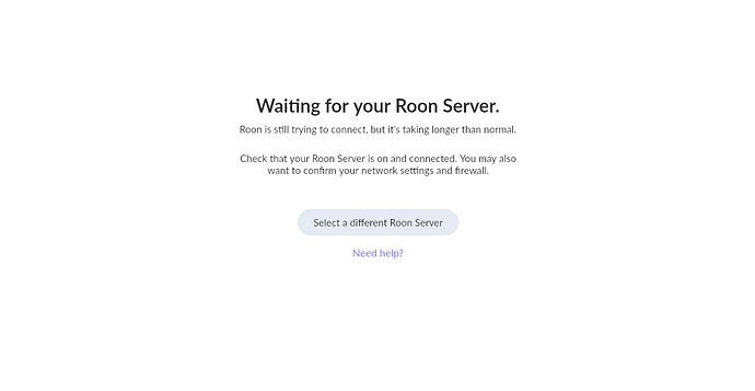

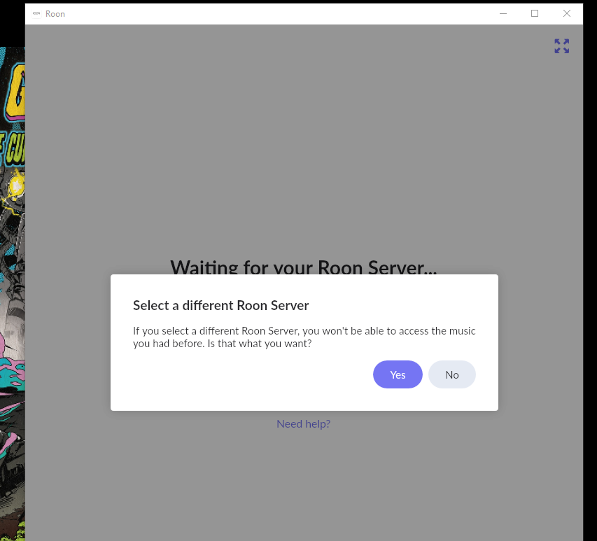

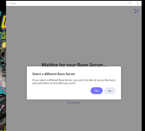

Have now been able to rename RAATServer to RAATServer_old and these messages come up.
Can I now select a different Roon Server, which will delete the old one?
Hi @Mark_Maddison,
Yes, you can select a different Roon Server, and doing so will automatically generate a new RAATServer instance. Let us know if you run into any trouble—we’re here to help!
Hi Daniel and the Support Team
Problem is solved. Don’t know what actually caused the Oppo to be lost but now I know how to get it (or any device) back again. Thank you so much for all your help!
