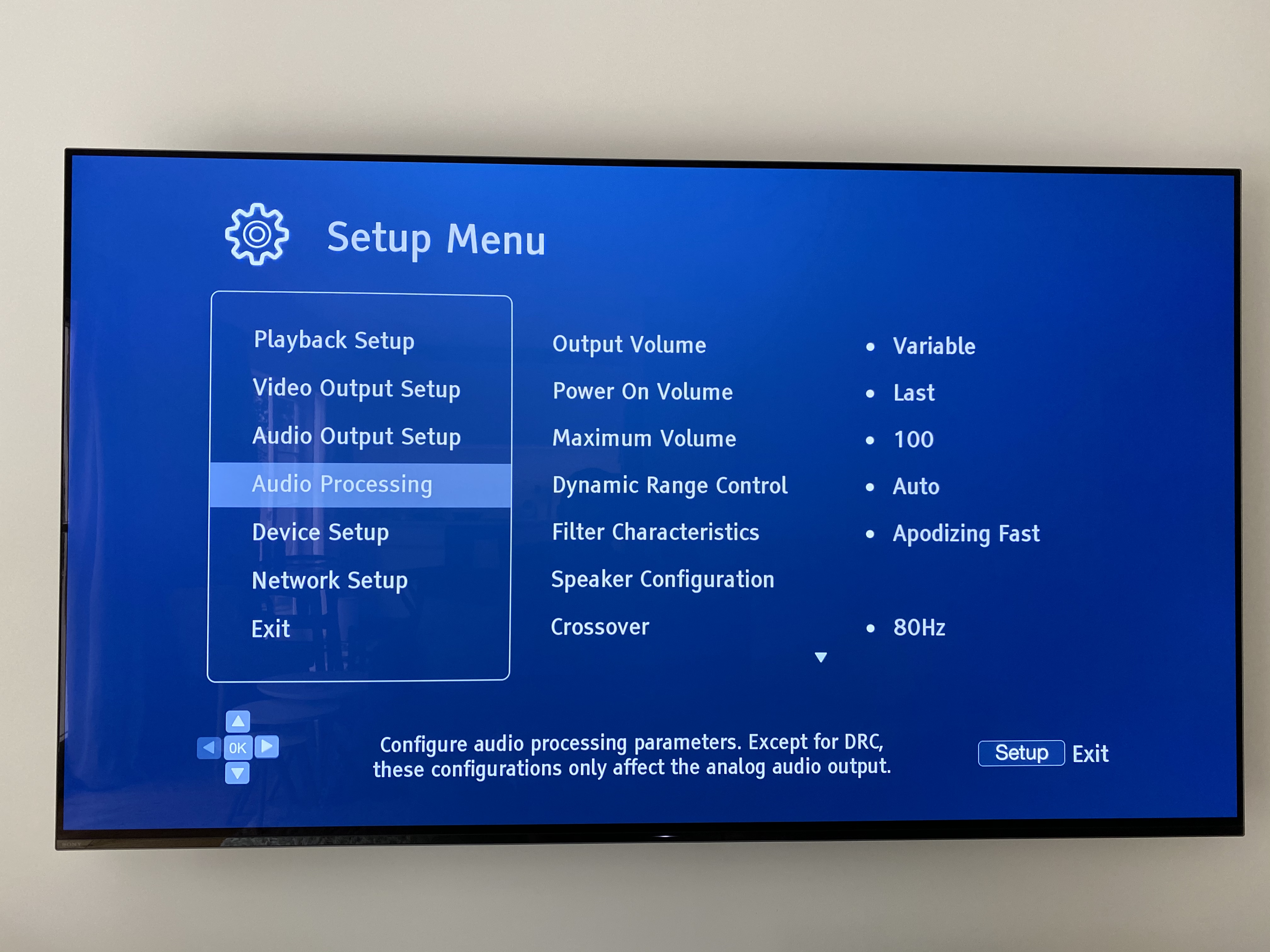

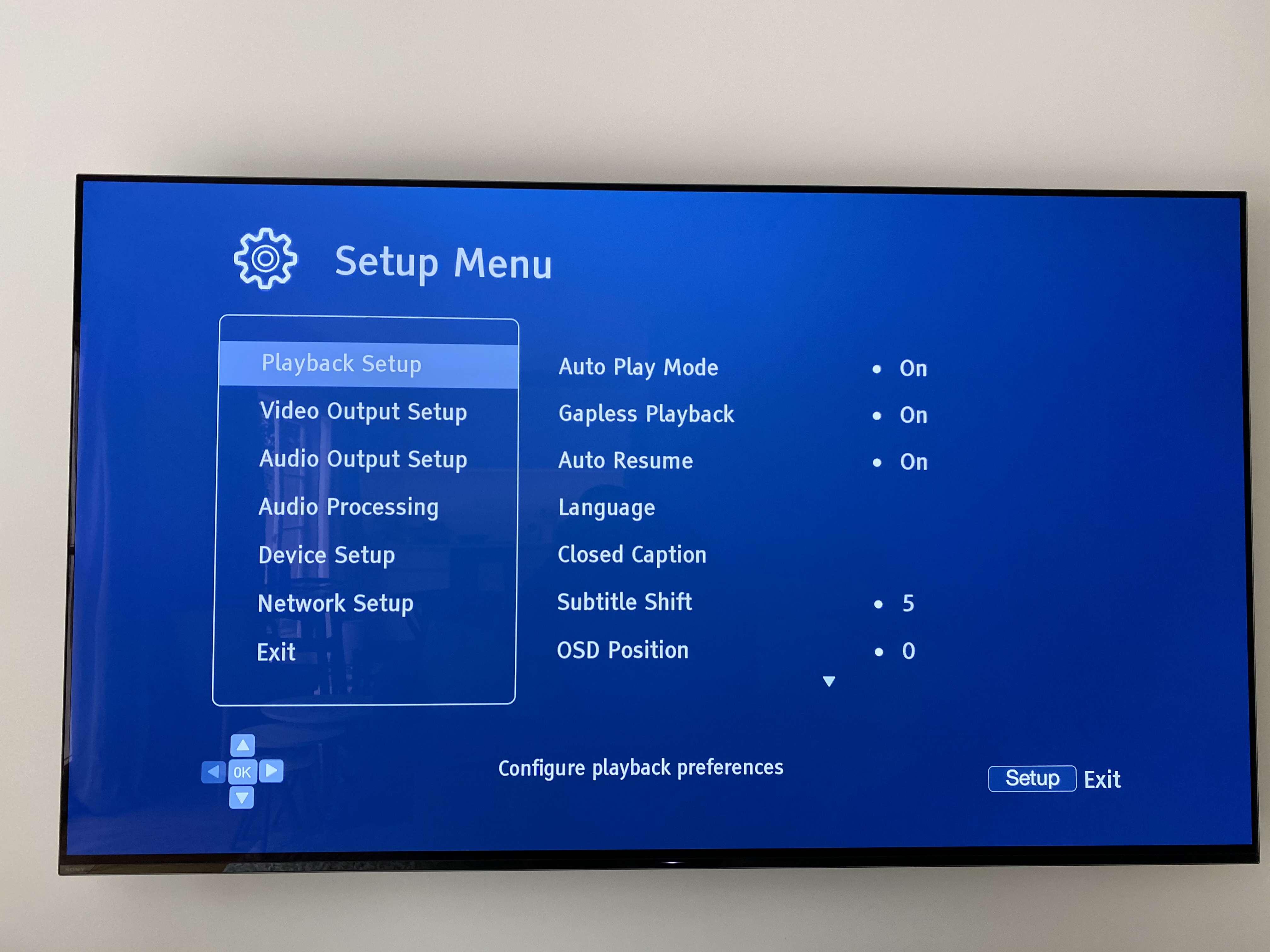

Finally, these are the relevant settings on the Oppo:
My first comment is to change your Oppo’s Output volume from Variable to Fixed.
