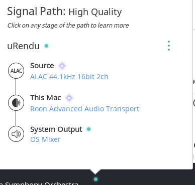

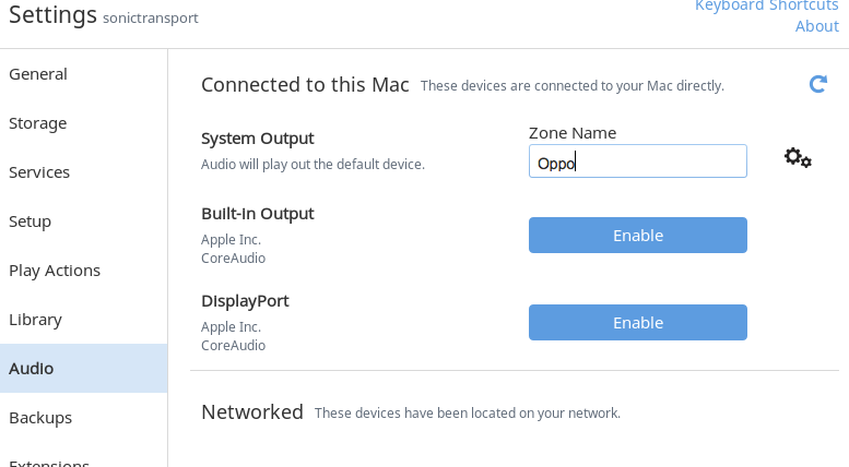

Hello Noris and Support team
Status report: Have remote control working, and sT and NAS visible on the network-normal ping response.
But audio comes through the Macbook but the uRendu/Oppo HE2 DAC is not visible in the Setting/Audio/Network pane, so cannot select. How do I re-direct audio to the DAC in the following set up?

Named the system output uRendu. No Networked devices displayed.
15%20PM
51%20PM
Bottom Line, Oppo DAC not recognized and no audio.
