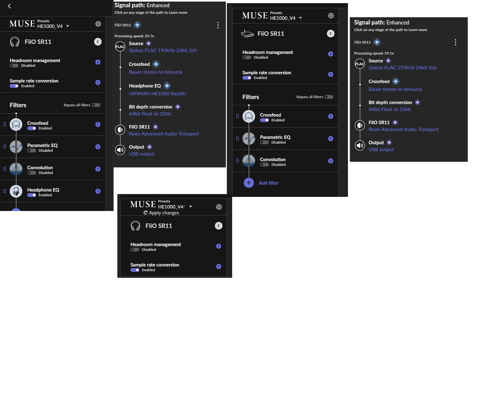

**Issue with OPRA Headphone EQ Settings Across Different Connections**
It appears that OPRA does not reliably save presets for Headphone EQ, leading to inconsistent behavior.
**Steps to Reproduce the Issue:**
1. Navigate to the MUSE DSP menu.
2. In *Zone 1*, configure a combination of **Headphone1 + Endpoint1 + Preset1 (With Headphone EQ)**.
3. Turn off **Endpoint1**.
4. Switch to a different zone that does not use Headphone EQ.
5. Turn off **Endpoint1** in this zone as well.
6. Turn **Endpoint1** back on.
7. Switch back to *Zone 1*.
- At this point, you’ll see an "Apply Changes" notification under the preset (refer to the attachment).
8. Turn **Endpoint1** off again.
9. Turn **Endpoint1** back on.
- Notice that the preset has been reset (refer to the attachment).
**Observation:**
Each time I switch devices, I must manually reapply the preset to reload the settings.
**Additional Notes:**
This issue does not occur when using a convolution filter; in that case, settings remain independent and unaffected. This indicates a potential implementation flaw in how OPRA manages EQ presets across devices.
You can replace Step#2 with Convolution EQ and it does not have the same issue
Please see the attached screenshot for reference.

Roon are already on to this and have rolled out a fix on Early Access. All being well it should transfer to full Production release soon.
Hey @Anthony_Chan,
Good catch! @SukieInTheGraveyard is correct - we have a fix currently in our Early Access branch that should be making its way to our Production version soon.
Thanks for your patience in the meantime! :pray:
