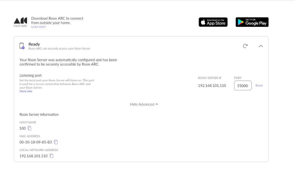

Hi Connor - thank you for this and hope you had a nice Christmas.
My ARC config details are in the attached snip. I can’t figure out what is going on as the settings seem fine. Earlier today, I tried ARC in the car. A menu pops up but no content is seen. Any tips or advice to fix this are welcome.
Thanks again, Marc
Hi @Marc_Brillon,
Was this with Tailscale or port forwarding? If you’re using port forwarding the thing to understand about this page is that it tests a connection from your server to our servers through the port you opened. It doesn’t actually test the connection to your phone. What this means is that something like a VPN on the phone itself or on your Roon server is blocking the connection. Is anything like that active on either device?
