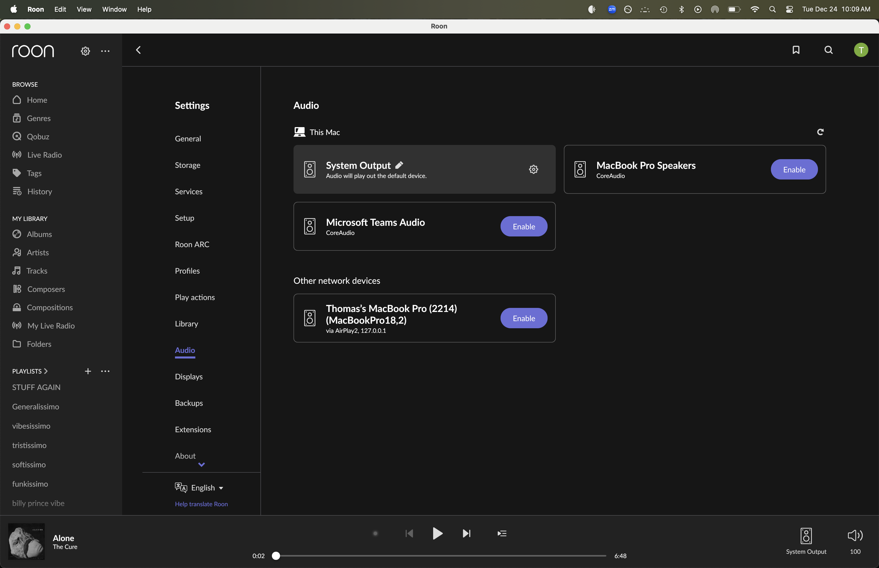

Hi there, having a strange issue getting Roon to recognize my two network devices (Lumin U2 Mini and Naim Uniti Atom) on one of my MacBook Pros.
I have two MacBook Pros, an M1 and and M3. Both were running Roon working perfectly, and were able to find both of my devices (Lumin U2 Mini and Naim Uniti Atom) and play to them over my home network.
Suddenly the Roon on the M1 Pro can’t find anything. Everything still works perfectly on Roon on my M3 Pro.
The fact that everything works great on the M3 and not on the M1 indicates that this doesn’t seem to be a network issue, but rather some configuration issue on the M1 MacBook itself?
If you are running macOS 15 Sequoia, this sounds like the frequently reported Sequoia network access issue. Try and navigate to macOS System Settings > Privacy & Security > Local Network, and make sure Roon is allowed. If it is already enabled, toggle it off and on again. Then reboot your Mac, and see if the same issue persists.
that did it, thanks!
Be aware that if Roon updates or if you restart the machine it might need the same thing again (it’s apparently not the case for everyone but for others it is).
Seems to be a combo of somewhat unreliable permission prompts in macOS for this new feature combined with necessary changes imposed by Apple that applications should make. The support said that development is working on it.
