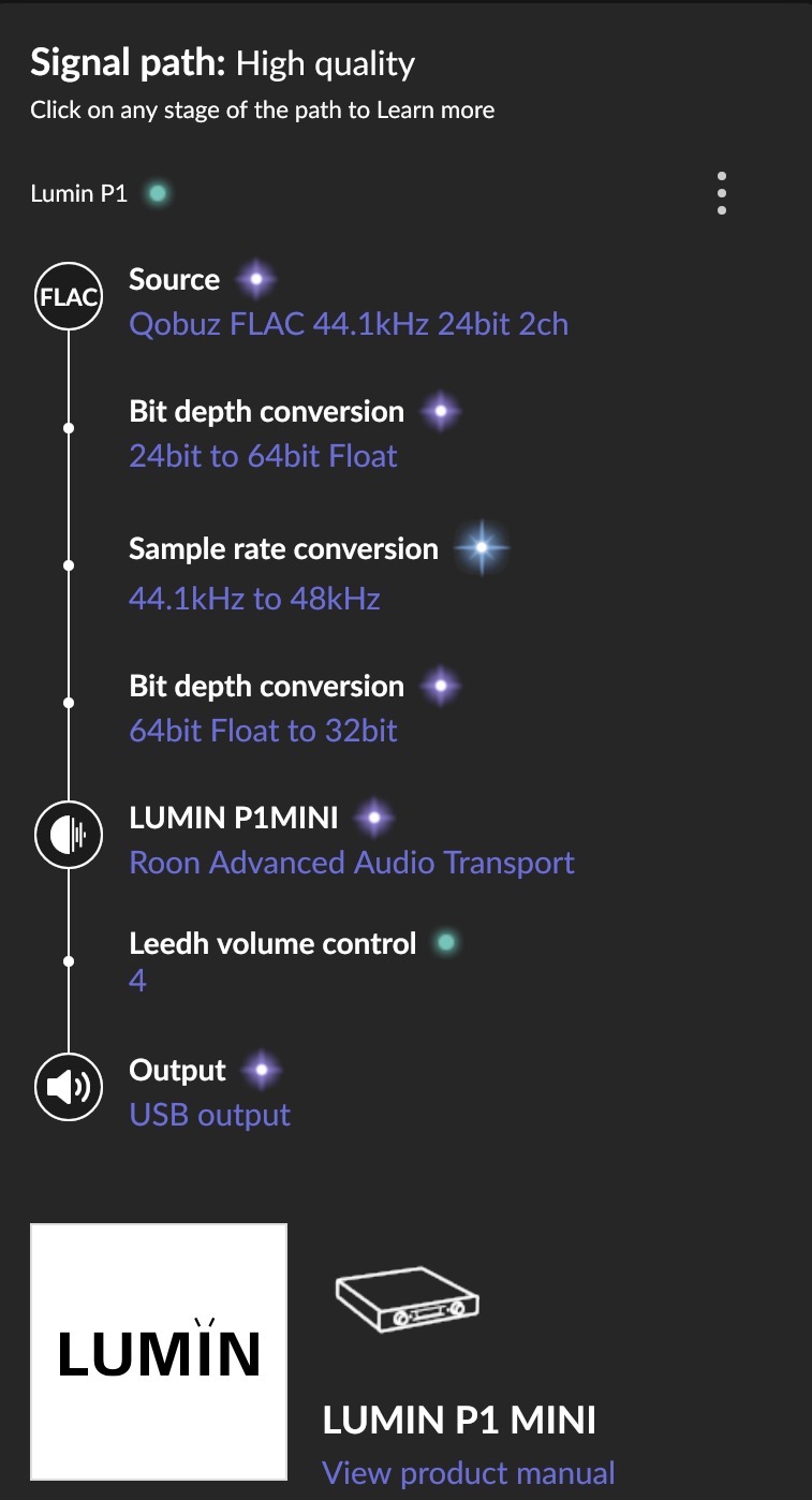

Hi Pete,
Hopefully my signal path shot will be helpful with regard to Audio/Dac query & what can be done.
Video & Sound I’m less sure about….will try to add more later…
Thanks PixelPopper,
That’s an encouraging start. Highest quality volume control to the USB output from streaming. Fingers crossed that the same will be true for analog, ARC, and/or digital coax inputs.
