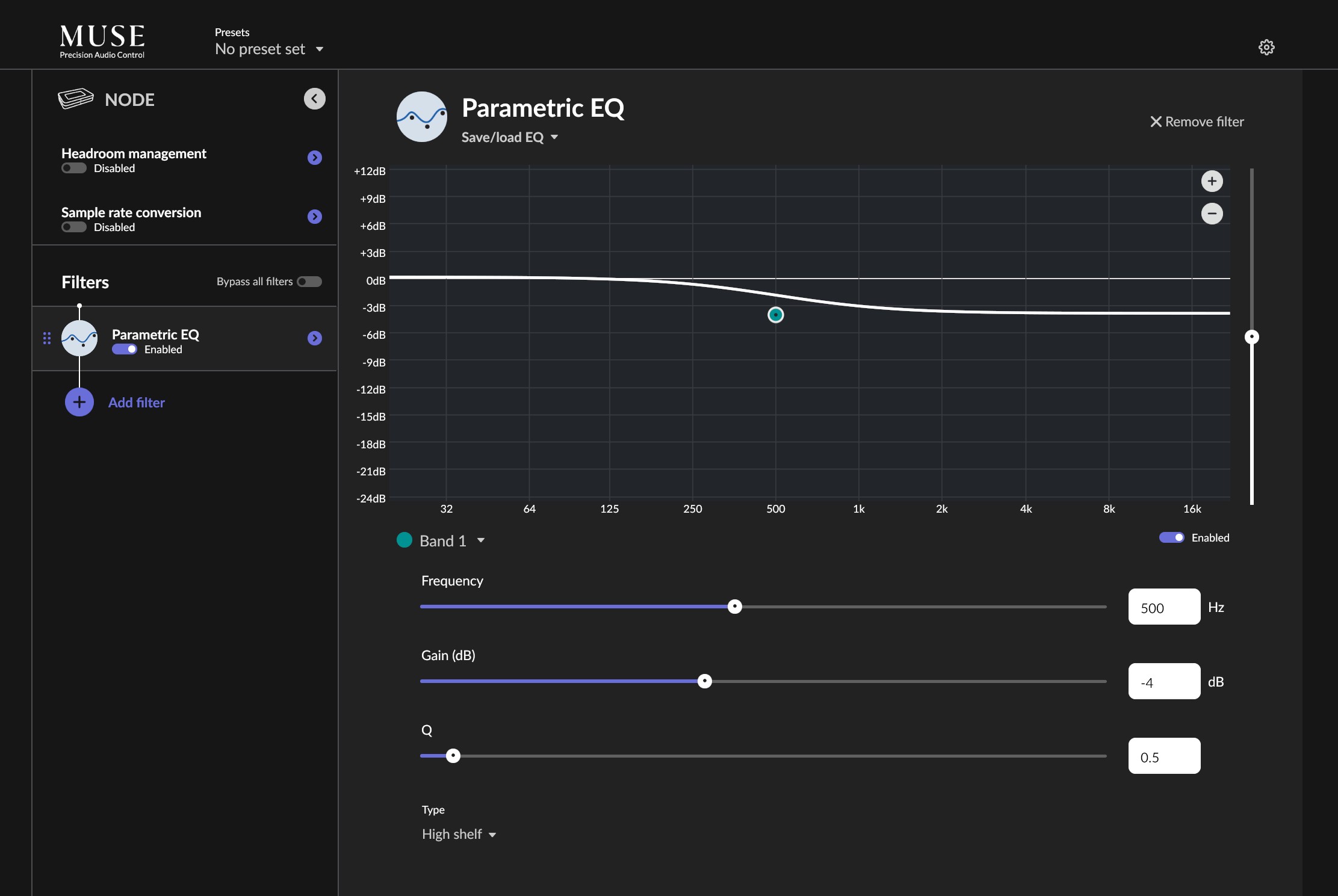

Hi,
I have speakers that are already a bit bright; Focal Aria 926, I have quite a few albums where the high tones can sometimes sound a bit too sharp, especially with albums that are already a bit brighter.
I would like to do something about that. I have already done a lot with regard to speaker placement.
I listen to my music via Pure audio on my Marantz Cinema 50 (Bluesound is connected and I use a mini PC as Roon server) so there is little to do in the receiver for the high tones, toe in, toe out etc I have already done further and of course the acoustics.
I see that the parametric EQ can be a handy tool, but I can’t quite figure it out, I’ve read several articles on the forum about this, where it was indicated as a starting point to use the high shelf option.
However, after a lot of playing it still doesn’t sound very pleasant, is there anything to be gained from the screenshot that I can do better, there are 5 bands, can I do something with that or do you have tips, I want a more uhm warmer sound. thanks in advance.

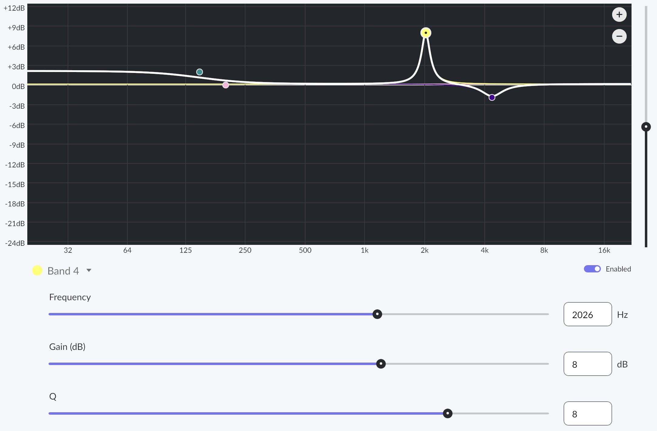

My personal method of tracking them down is usually to listen to a particularly annoying track setting a very narrow-banded peak parametric filter such as a 3.5K, Q=10, +8dB as a starting point, playing around with the frequency in very small steps.

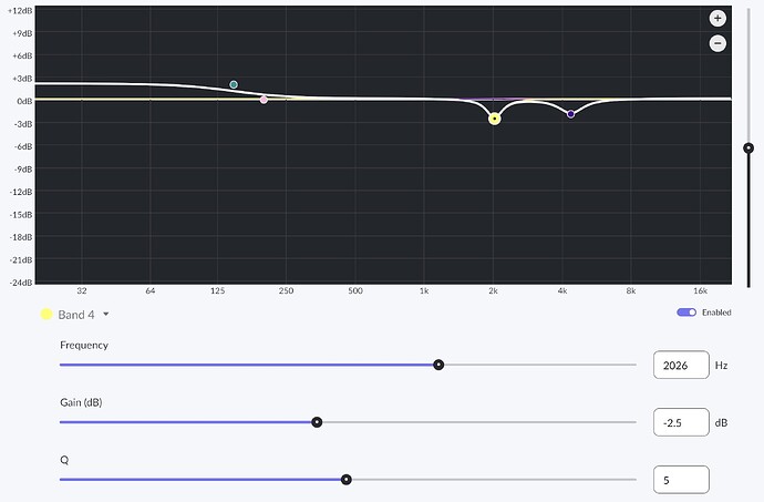

If you have nailed down the most annoying band, you reserve the filter to a slightly broader dip filter, e.g. Q=5, -2.5dB at the same frequency and play around with the level of attenuation. As mentioned, this methods requires listening experience.
