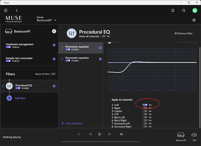

Yes. It is possible using a desktop client to configure different parametric EQ for each channel on normal Roon Zones. It is not currently possible in ARC.
Create a Procedural EQ filter and then, within it, create a Parametric Equalisation operation for each channel. E.g one I created just for illustration:
Showing the left channel setup:
Showing the right channel setup:
