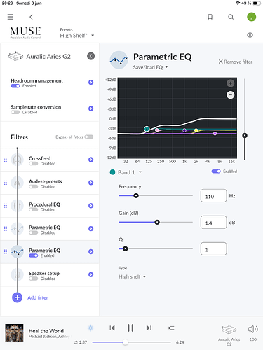

I am sorry if this is very basic. I was fooling around with the EQ and found a setting that sounded very good. Do I have to be careful with the gain not to damage my equipment ? I read something about clipping ? Please see picture with the details.
You increased the volume above 0dB nearly across the whole band, so it’s probably going to clip.
You can either move the whole band down below 0dB (see the slider on the right) or enable the Headroom Management filter and reduce by 6dB or a little more.
The clipping indicator is only active if Headroom Management is enabled. (Even if the reduction value in its settings is set to 0dB). Then the signal path „light“ in the play bar at the bottom will turn red whenever there is clipping. Increase the headroom (or move the whole band down in the EQ) until it stops doing that.
That is interesting as this shelve filter is basically just reducing all bass frequencies by -6dB. Is it sounding good on loudspeakers or headphones?
As the bass - which you have not boosted - is in most of cases carrying the chunk of energy, you might notice clipping only occasionally (e.g. during level peaks, midrange-heavy and loud recordings, recordings compressed beyond reasonable leveling or alike). Nevertheless it is advisable to normalize the overall level after setting the EQ filter manually using the black master fader on the right. In your case it might look like this:
This -4dB overall leveling should ensure you will not have clipping while not overly wasting headroom.
