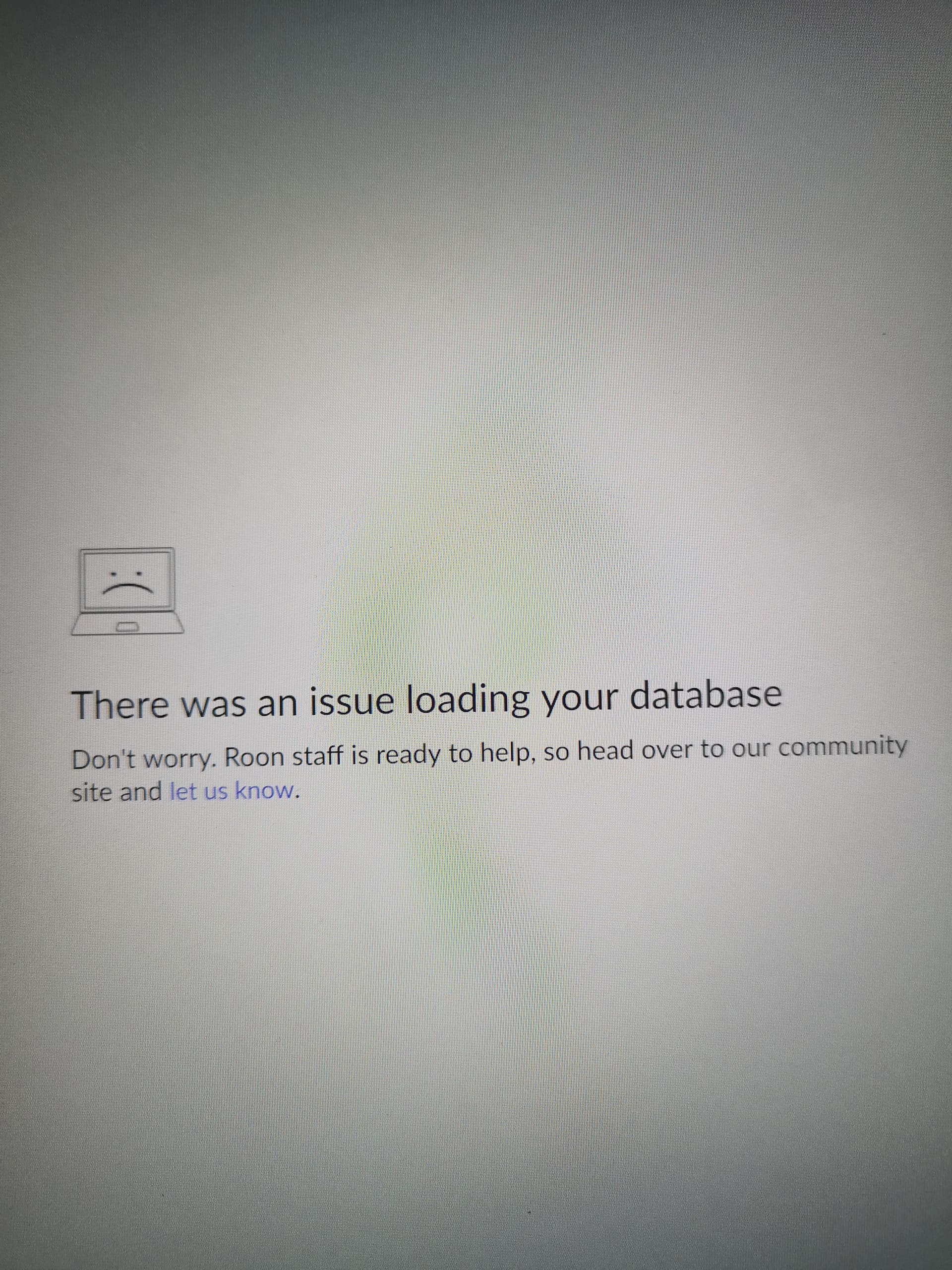

Can,t start roon with remote App
Database seems Ok
As screenshot no connection. Roon rock is recognized in my network

Based on your latest screenshots, it’s very likely that your database is corrupted… :sweat: This type of error is extremely rare for us as our database infrastructure is designed specifically to prevent this type of corruption, and we don’t take this class of issue lightly.
We’ve traced a few reports like this in the past to hard drive integrity issues but generally speaking, this means that Roon is reading information from your hard drive that is different from what was originally written, and the database is now unable to load properly.

Dear Rebeka,
Thanks for your advice. After renaming the folder and generating a New Roon data base folder i,m back to life.
Thank,s a lot :grinning:3
