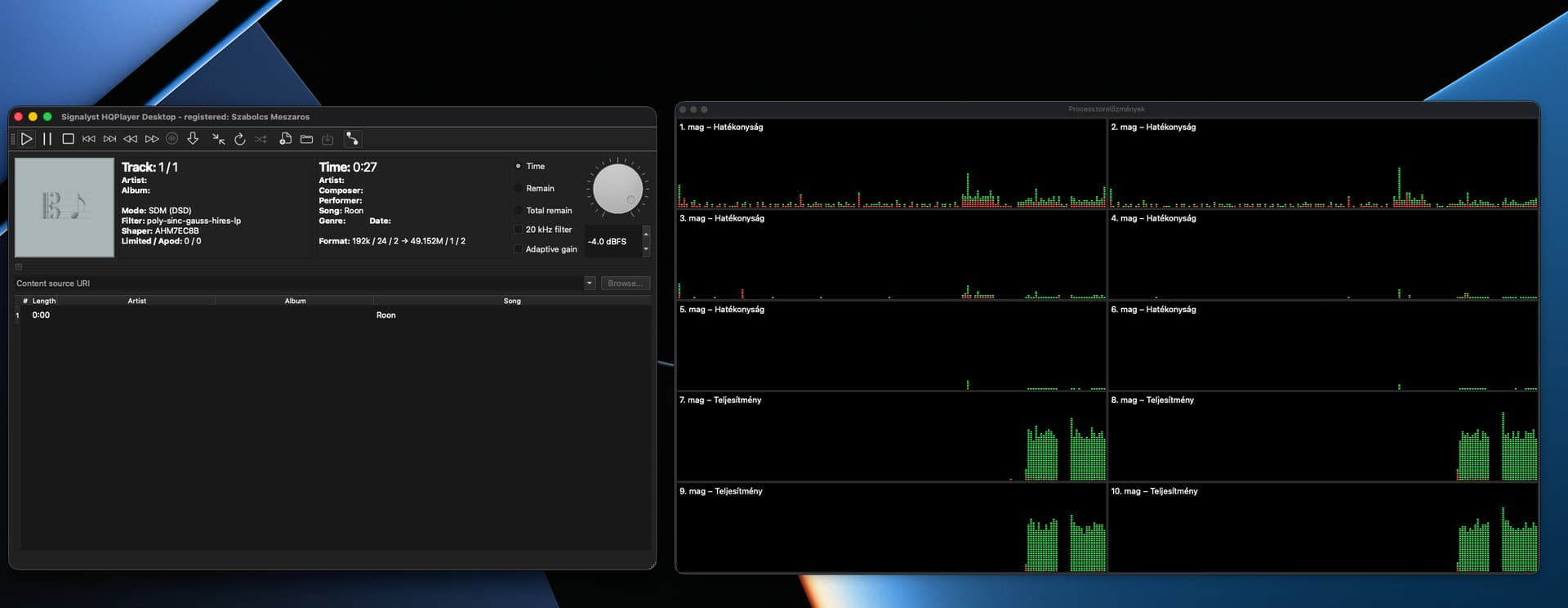

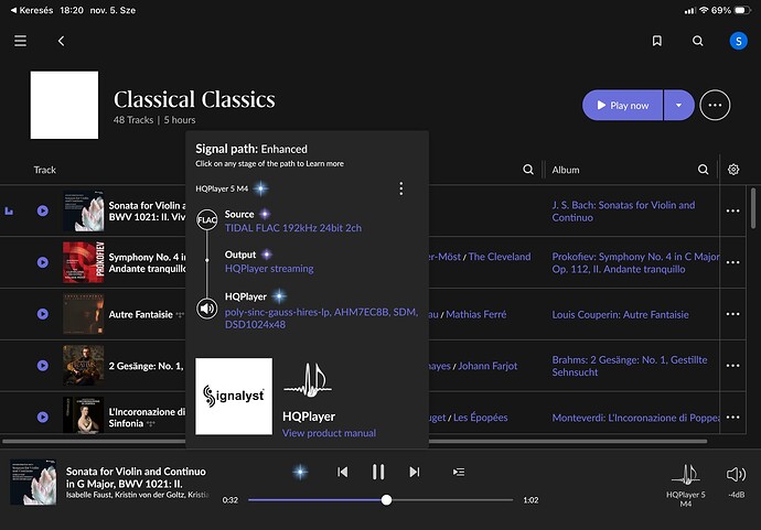

I3-8100T Mini PC in server room (Roon Server) -

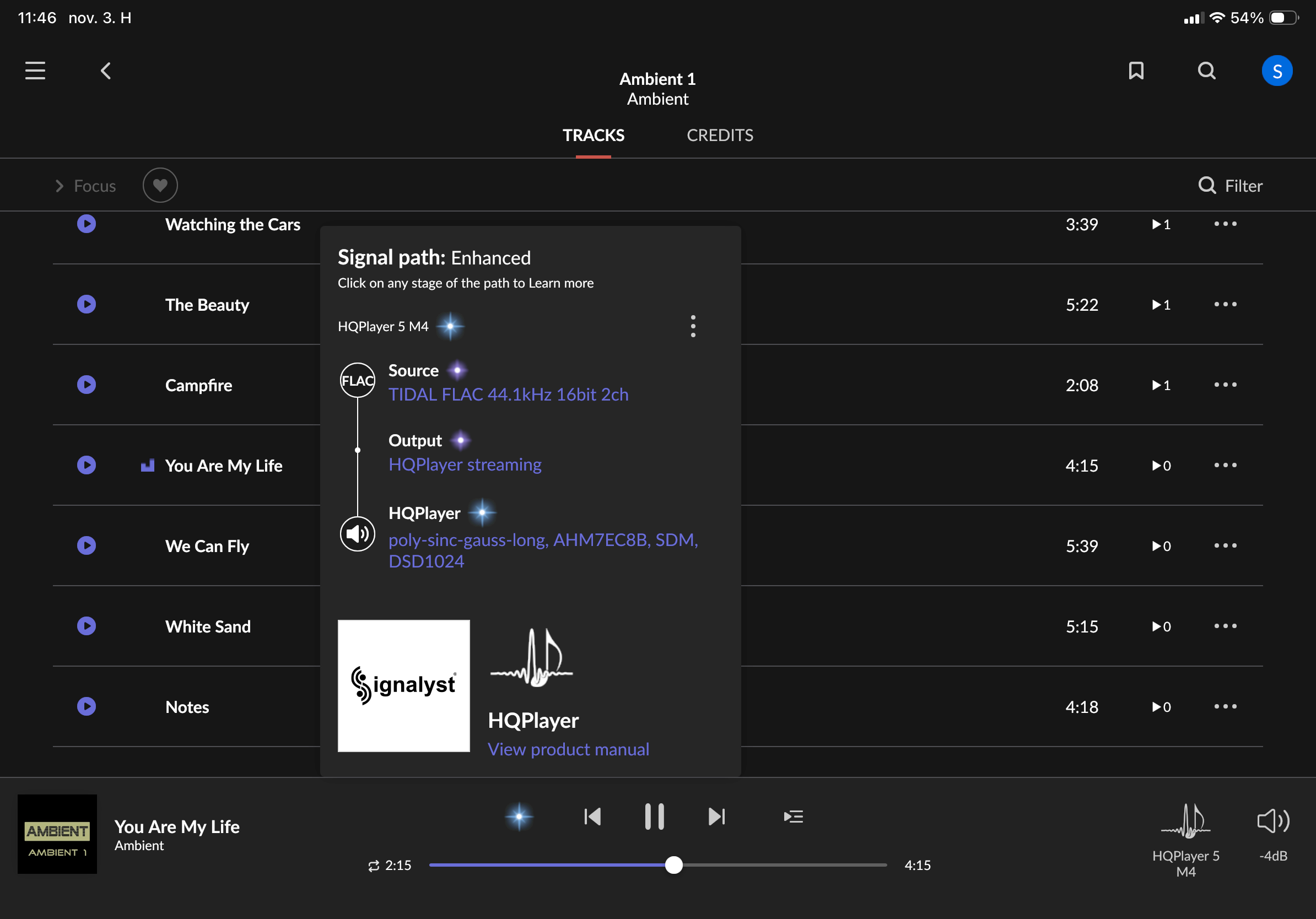

Apple Mac Mini M4 Base model (HQPlayer 5 + DAC Correction) it’s Super silent!

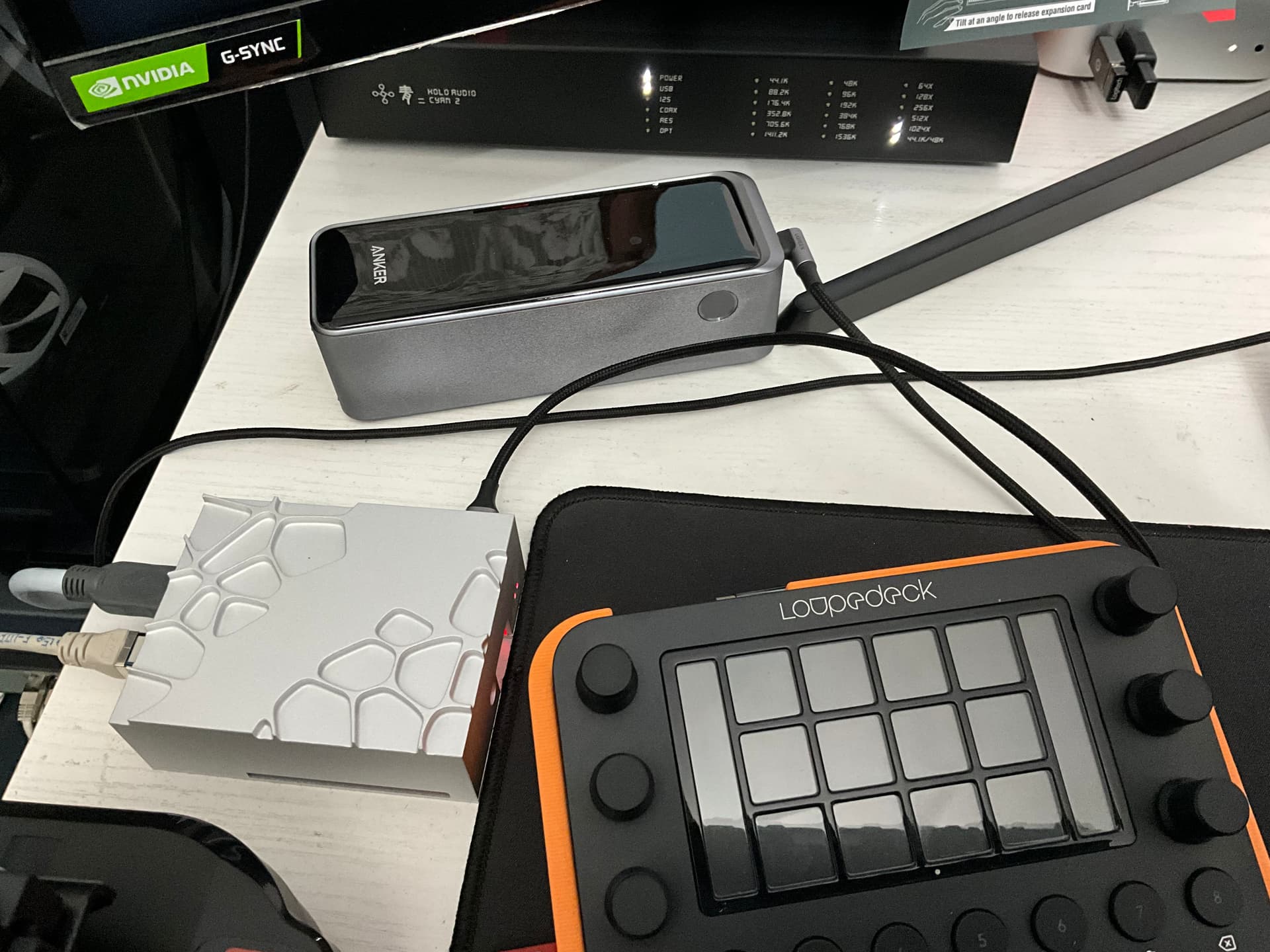

RPI4 HQPlayer NAA
Holo Audio Cyan2

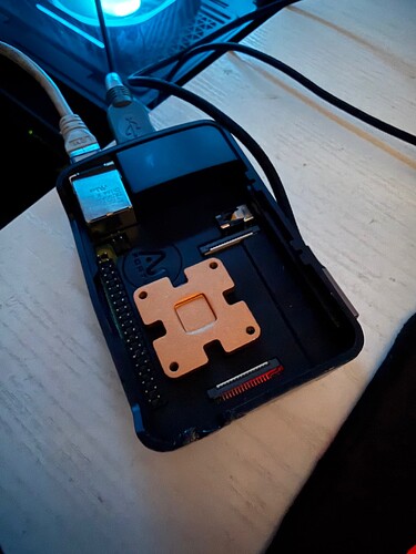

So far it works perfectly! The RPI4 will be moving to a new all-aluminum case. (Akasa Gem Pro) A-RA09-M2S)
Akasa Gem Pro

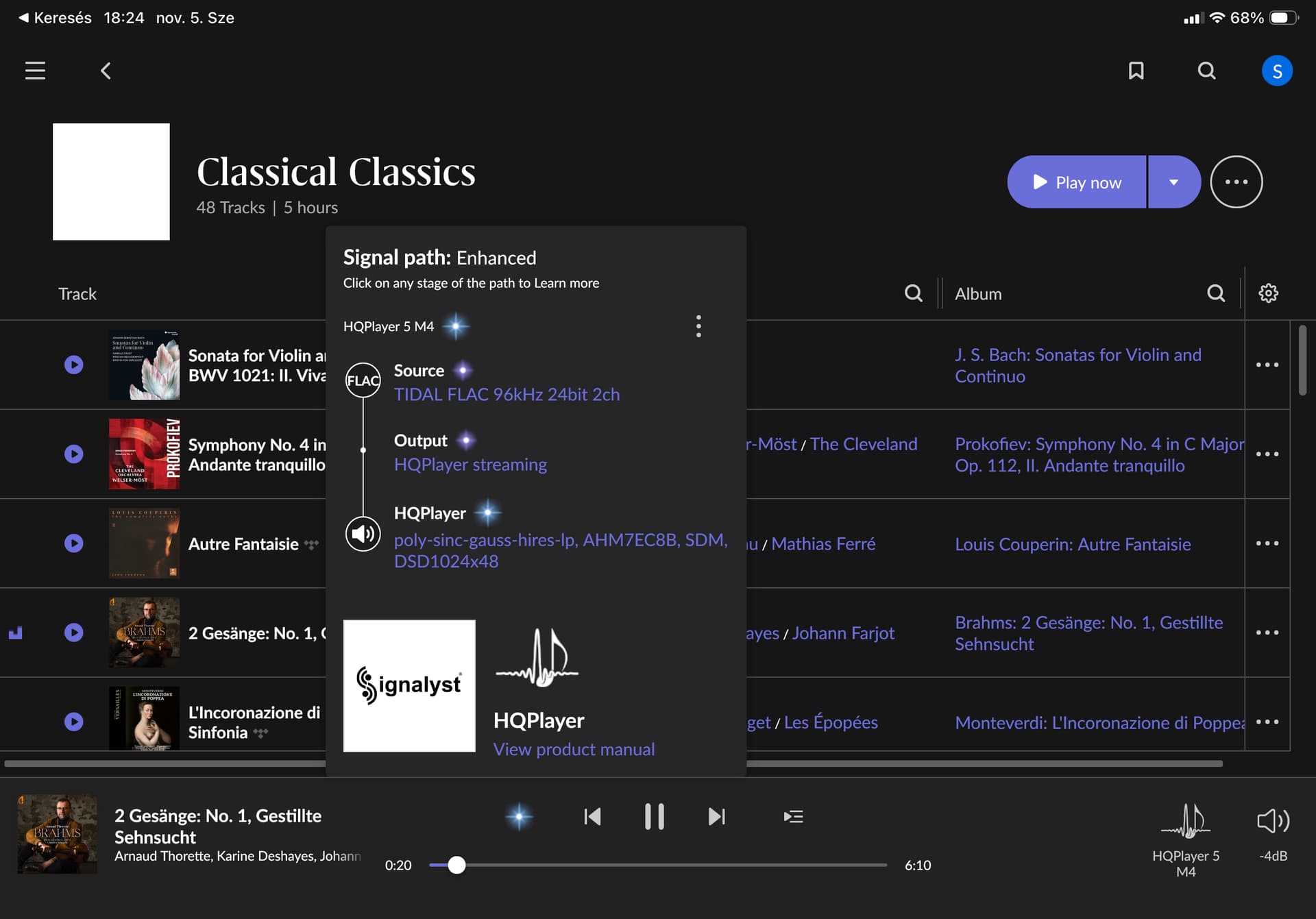

If you start with a flac file that has a higher sample rate (96, 192, etc.) will it still work? My M4 Studio will pause randomly with those files.
It works flawlessly with both 96 and 192khz files.

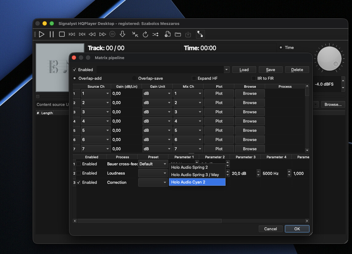

Interesting. Mine definitely has intermittent pauses when starting with hi res files. Maybe it’s because I have DAC Correction turned on with my DAC 200.

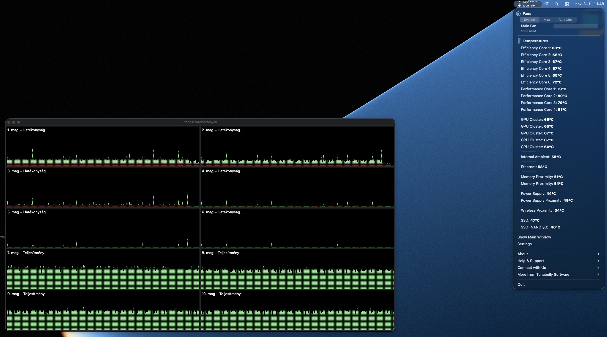

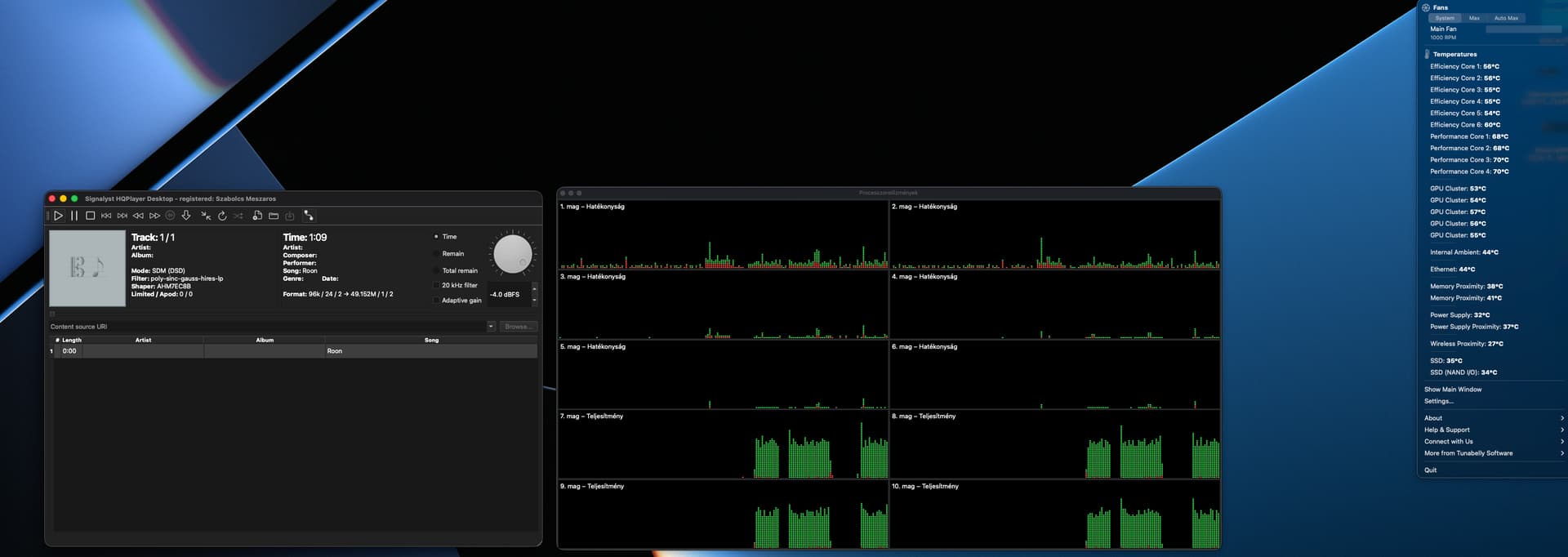

It is also important to remember enable High Power Mode:
Otherwise it will thermal throttle before reaching maximum performance.
I don’t think the M4 Mac Studio has the option to do that.
I also have DAC correction turned on. :slightly_smiling_face:
Maybe some service is running in the background? Mine is a brand new machine, with a brand new system. There is almost nothing installed, just HQPlayer and TG Pro. I bought this machine specifically to run HQPlayer. This is my dedicated PCM/DSD upscaler.
Apple “M-Scaler”. :grinning_face_with_smiling_eyes:

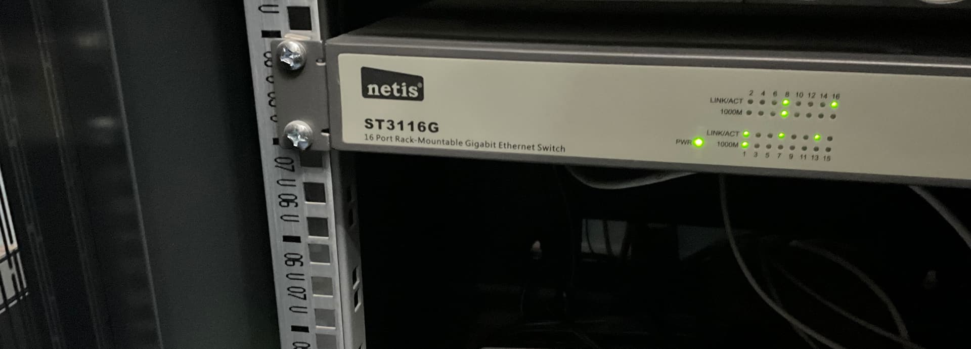

This is my 16-port Gigabit switch:
Continuous, stable operation! (24/7) All wired network devices are connected here. :smiling_face_with_sunglasses:
