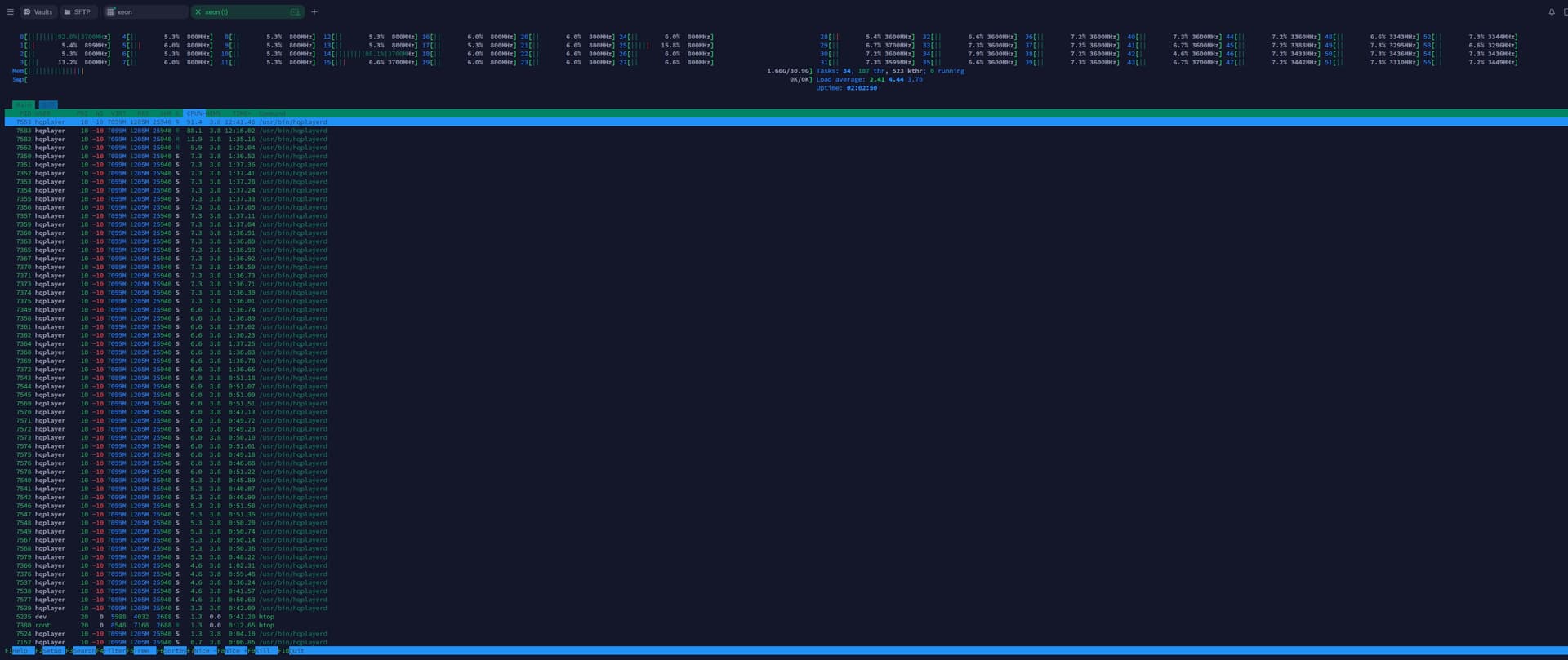

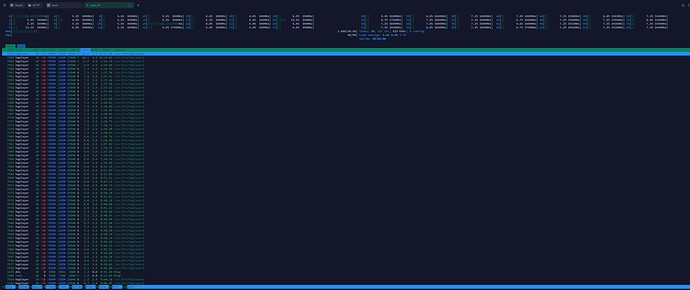

Ok, here is a bottom line. Xeon CPU’s are awesome for HQPlayer.
I just grabbed an engineering sample for like $200 or less. Its a 8480+ that was 56cores and max turbo frequency 3.7Ghz. 28 cores can run 3.7Ghz simultaneously. With registered DDR5@6000Mhz CL32 i am able to play DSD1024 with ASDM5EC-Fast 512+fs or ASDM7EC-Fast 512+fs, poly-sinc-gauss-long. Load per core is 60-90% but it plays smooth and sound, without offloading, running HQPlayerOS. Imagine a w9-3565X at 5Ghz+
I’ve disabled half of the cores, but cant disable hyperthreading.
