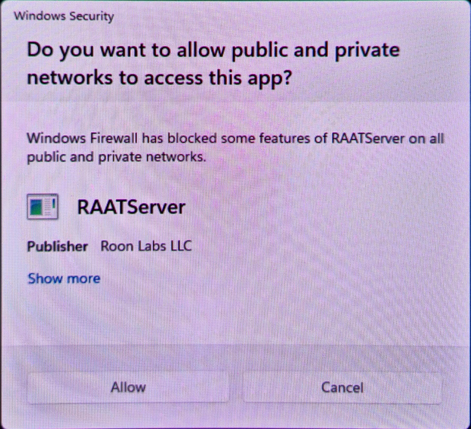

Well, there’s definitely something odd here.
I made the procedure as per your instructions. Also rebooted both ROCK & PC to ensure all the changes are in place. Started PC, started the Roon app. The window (pic below) jumped out. I clicked “show more” and added both public & private networks (even though I had done it in the previous phase). Checked the Audio Zones, but my PC is not showing up.
I went back to the Defender and noticed that not only RAATServer, but Roon and Tidal were all showing red. Clicked them on, allowed - again - for both private and public.
But, no result. The Roon still cannot see my PC as Audio Zone.
