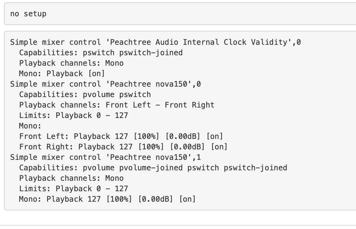

@Jesus_Rodriguez does the screenshot above help with knowing if his DAC supports ‘native DSD’ mode with Linux (ultraRendu)?
That DAC only works up to DSD256.

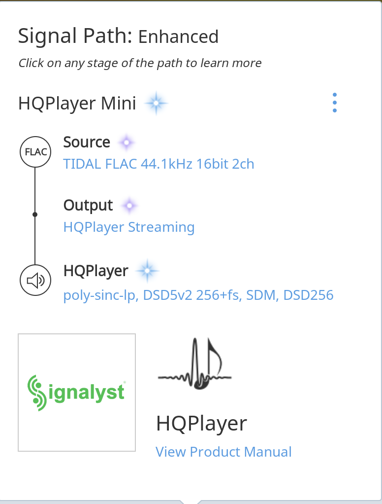

Now, the following combination does seem to get me to DSD 256 output, and Roon seems to indicate that something is playing, but I hear no sound.
