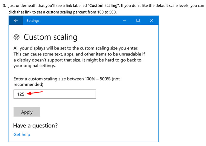

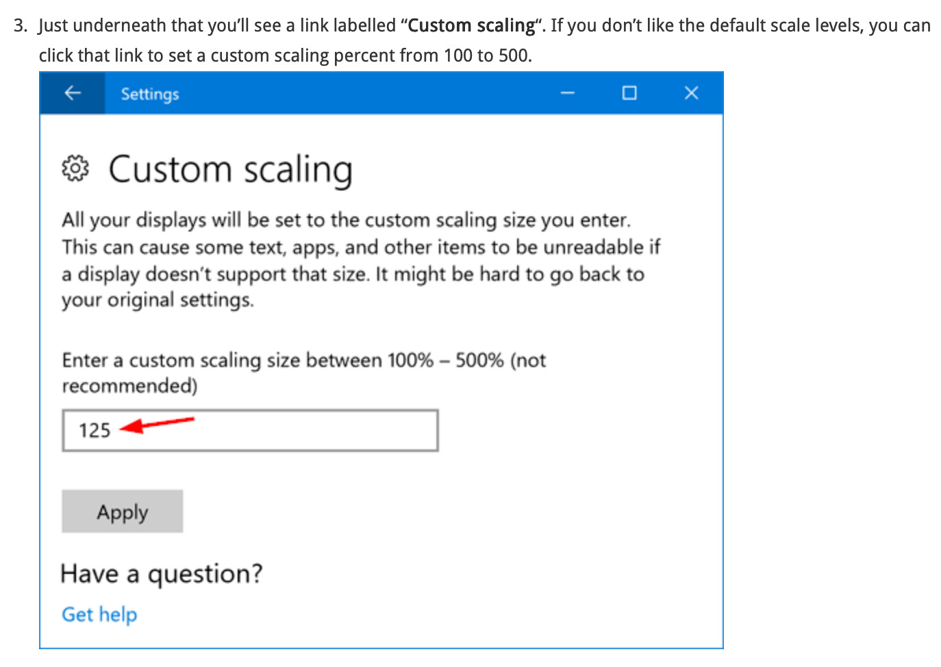

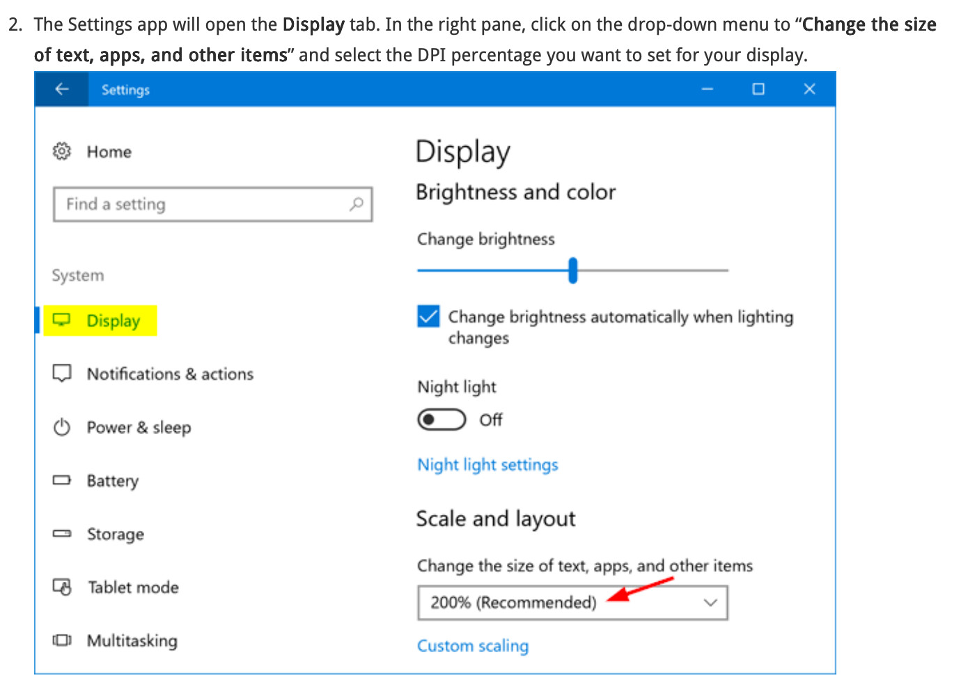

For the screen resolution message, please see this article:
. What is the current resolution that you use on the affected device? Are you making use of any display adapters/hubs?
Hello Big Dan,
My current resolution is 1920x1080. I also completed the action in the article. To no avail…
What’s your Windows display scaling value?
or do you per chance have a custom scaling?
Okay I think i have solved the issue and it was not the Roon article on DPI Setting. I left the resolution at 1920x1080 but changed the scaling from 150 to 125 and that parameter change made the difference.
