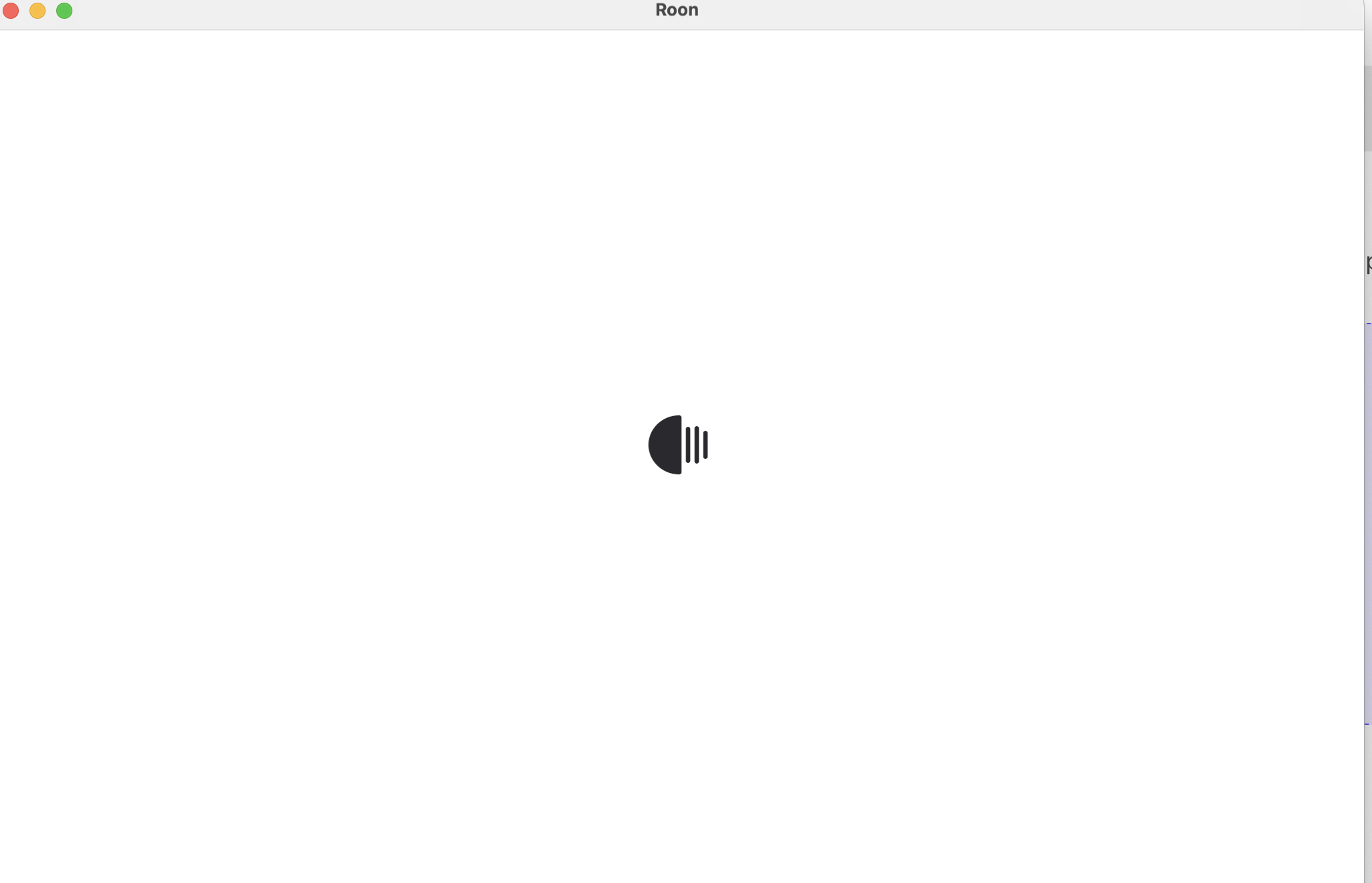

I’ve been experiencing persistent issues with connecting to my Roon Server, which is installed on my Mac running macOS Sequoia 15.5. This has been a recurring problem for quite some time now.
A couple of days ago, the connection was re-established and everything worked fine for a short while. However, today while listening to music, the connection suddenly dropped again. Once more, I am stuck with the app endlessly “searching for Roon Server”.
This is becoming increasingly frustrating, especially since the server and core are installed on the same Mac where I’m primarily using Roon. I would really appreciate your help in identifying and resolving the root cause of this issue.
Best regards, Olli Sundqvist
The Roon server is installed on the same Mac that I use. It is connected via Ethernet, in case that makes any difference.
