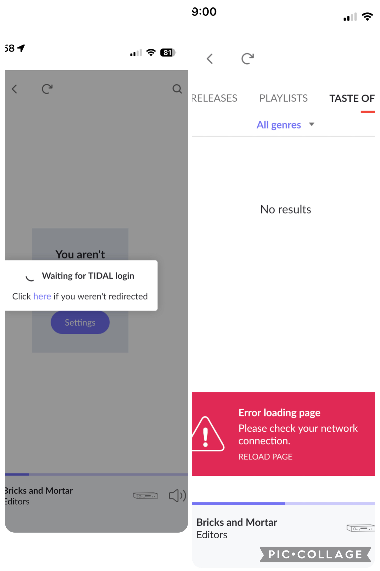

· I can't log into TIDAL, KKBox or nugs
Have you been redirected to the Tidal/KKBOX/nugs login page in your browser?
· Yes
Content / Popup Blockers
· I don't know what it is, I need a guide
Different device
· I am able to switch to the diffrent device
Record the timestamp
· Timezone Amsterdam 18:41 may 6 2026
iPhone 15, IPad 2025, Mac mini M1 Tahoe 26.2, Roon version 2.65, Roon server version 2.65. I’m not very good at this anymore, please let me know if you need more details. This started (network problems) about 6 weeks ago with my old Mac Mini i7, I replaced it with a Mac Mini M1, but the problems did not resolved.
Ziggo Connectbox, TP-link Deco X60 (never had any problems before!).
ISP Vodafone Ziggo [moderated: public IP address removed]

I tried and it only got worse.
