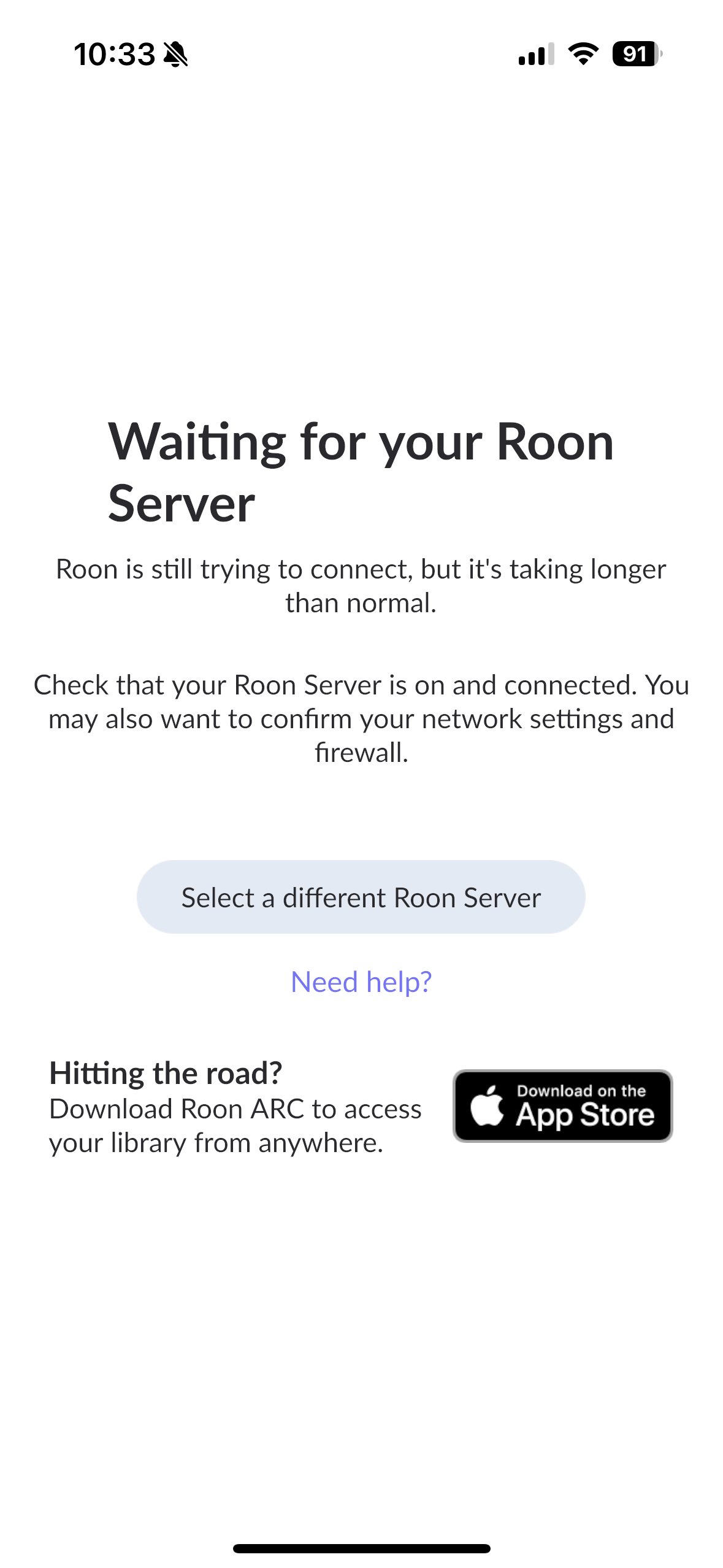

Persistent "Waiting for your Roon server" message after update (ref#5DGP2B)
Is Roon Server running?
· "Waiting for your Roon Server"
What happens if you press the "Select a different Roon Server" button?
· I see my Roon Server, but I still can't connect.
When you try to connect, what screen do you see?
· I see something else
Please try to restart your Roon Server by closing the Roon app in the taskbar or rebooting your Roon Server machine.
· *Roon Optimized Core Kit* (ROCK)
Roon worked fine until a few weeks ago. Whenever I try to connect, I get the “Waiting for your Roon server…” message. I have tried reformatting my server (ROCK on i5 NUc), and even tried to install Roon server on a different computer. Same issue, nothing is working. It almost seems like an update broke everything, or there’s an issue with my account. Please investigate
Ubiquiti UniFi Dream Router. NUC and Matrix mini-I pro3 connected via Ethernet, remotes (iPhone 16 pro, iPad Pro, M1 MacBook Pro) connected via Wifi

Hi Carl,
I can access the ROCK admin page from its IP address (10.0.0.200, subnet /24), but none of my remotes are able to connect. I even tried setting up a new server on a different PC, and the remotes were able to connect until I signed into my Roon account. Then it became slow and unresponsive and would not reconnect. This leads me to think it’s an account issue

Hi Benjamin,
Thanks for checking. I’m now able to access my ROCK when plugging my laptop or iPad into the network via Ethernet. Still having issues connecting over WiFi, but that at least narrows it down to a network issue.
Edit: all devices are on the same subnet (10.0.0.0/24), unsure why there are communication issues between wired and WiFi devices

Fixed the issue by reverting the router back to the previous firmware version (Ubiquiti DR 4.0.20). Thanks for the help!
