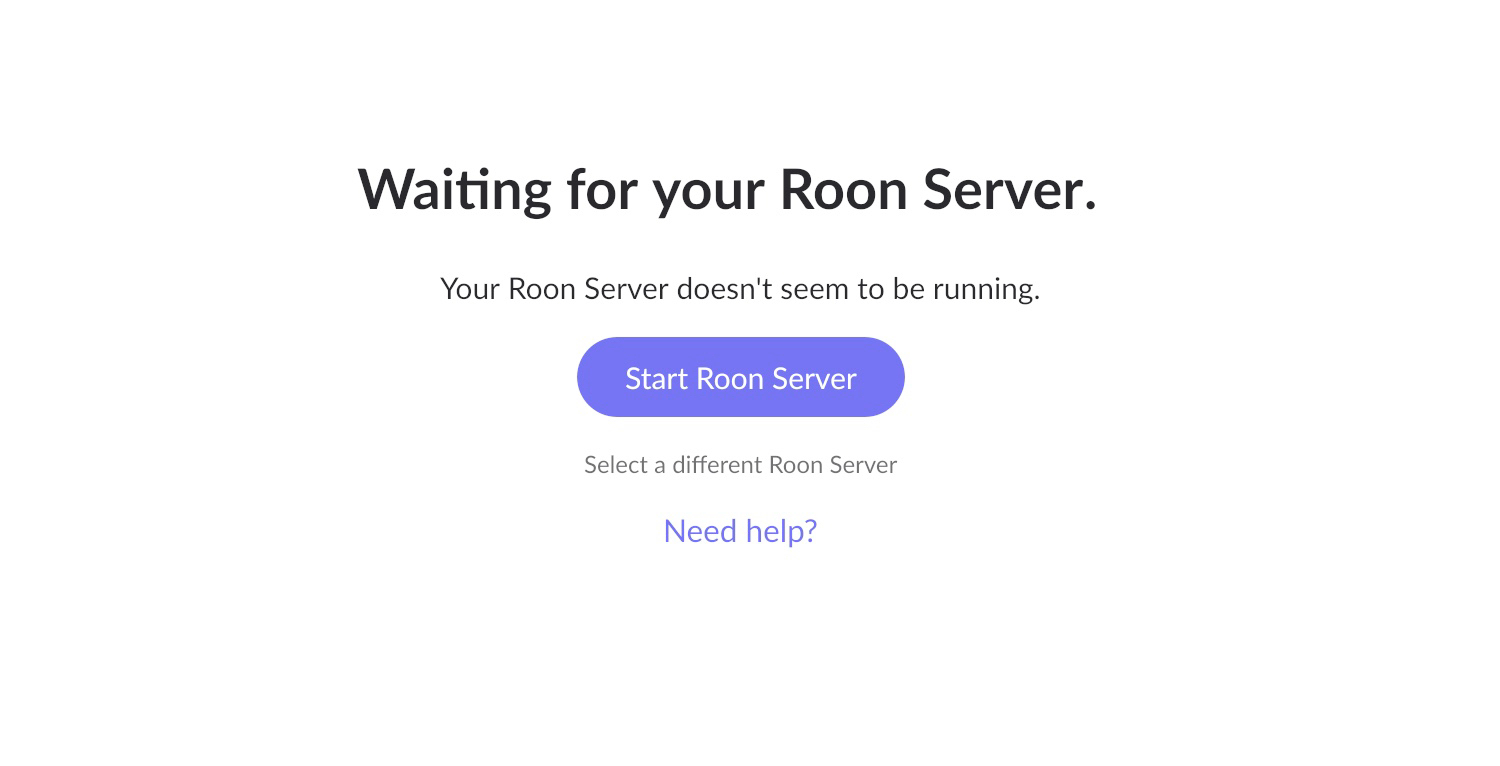

I keep getting the message, "Waiting for your Roon server" on the iMac that is hosting the Roon app
iMac is connecting wirelessly to router. This is a late 2015 model running macOS 12.7.5. It is a 4GHz Quad Core Intel i7 with 32Gb RAM and 1Tb SSD. This connects to a Vodafone Ultra Hub with wifi 6E. From this I run a network cable to a Roon Endpoint / RoPieee Streamer Pi4 B.
The iMac now fails to load the Roon server and when it does it often fails to see the Roon endpoints on the network.
Can you help me diagnose the issues on the network because it is now so unreliable that I will be forced to cancel my Roon subscription.
