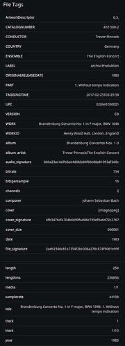

I have a collection of about 40k tracks which have been painstakingly tagged over the years. My FLAC credits are stored in the very common PERFORMER tags formatted as:
person (role)
Credits in my ID3 based files have the credits stored in the Musician Credits and Involved People standard ID3 locations.
role=person{,person}...
Yate can hide the PERFORMER tag and users never have to know about it. It is abstracted up to a high level display of Musician Credits and Involved People. These high level fields support various aggregation and sorting capabilities. Editing is standardized for all audio file types and you do not have to worry about delimiter formats or the final storage of the data.
