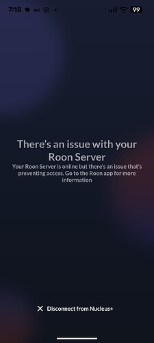

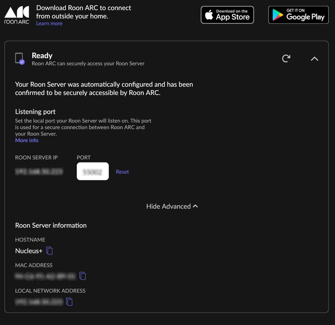

On my phone I get "There's an issue with your Roon server" but using Roon, says "Ready Roon ARC can securely access your Roon Server"
Netgear CM400 Modem, ASUS AX6600 Router, Netgear Switch and Ethernet cabling (Cat 6a I believe)
This is what my phone shows. This is a problem from time to time, but usually when I get home and reboot my server, it goes away. This time it didn’t.

Hi @Steve_Davies1,
If the Settings → ARC page lists a “Ready” status, then RoonServer can send/receive secure Roon traffic through the open port. This means ARC shouldn’t have an issue on cellular data unless your cellular provider is filtering downstream traffic (very rare).
The team implemented a fix in the last Early Access release for a highly specific condition that could emerge with IPv6 networks. This could possibly cause the symptom you were seeing.
However, the most common culprit for the “there’s an issue reaching your RoonServer” screen you’re seeing is an expired authentication between the ARC app and RoonServer. This happens when you do one of any three things: 1) restore a Backup, 2) reinstall/migrate to a new RoonServer, or 3) go about two weeks without syncing ARC to RoonServer on your home network.
The simple solution is to reinstall the ARC app as @Jim_F suggested. Please let us know if this helps.
